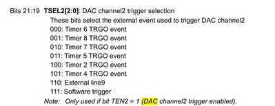

I'm using a Nucleo-F446RE Board and I'm trying to set up a basic DAC with DMA configuration without HAL-libaries.
The configuration without DMA works just fine, I can measure correct voltages with my oscilloscope on PA4 as intended. My following DMA configuration sets the PA4 always on 0V, nothing happens.
I checked the debugger and all registers are being properly set, DMA and DAC both have their clock and values.
It just doesn't copy the values into DAC->DHR12R1. I also checked the Flags in DMA_LISR, but no error there.
I'm probably missing somehow on how to start the whole process, so my last iteration of code tried to mess with software triggers. I also tried all combinations of PSIZE and MSIZE, as well as uint8_t and uint32_t arrays instead of uint16_t. I feel like I followed the stream configuration procedure from the reference manual, but I probably missed some small, gritty detail.
Anybody got code for a similar MCU or sees the problem in my configuration?

In the end i reverse-engineered a HAL-Example...
My lesson learned is: It only works with Timers and only with update in CR2 configured.
Here my working more or less minimal configuration with TIM6, for anybody struggling with the same problem:

With TSEL=7, you have selected software trigger, so you'll have to set DAC_SWTRIGR_SWTRIG1 for each value. If that's not what you want, select a different trigger and enable the TRGO event from that peripheral if using a timer.
I know, I didn't want this to be a final solution, I wanted to trigger _anything_. No value has been triggered with my setup, it's always 0.
I will try setting up a Timer 6 TRGO event next, although this makes the code more complicated and more error-prone.
