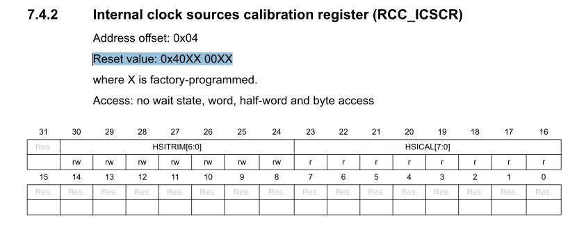

In the reference manual STM32G4 Series (RM0440) there is an error in chapter 7.4.2 ICSCR. The description of HSITRIM[6::0] says that the default value is 16. This is wrong. The default value for the G4 processor is 32.

Hello @Arnold Bischof​ ,
Thank you for bringing this error to our attention.
I confirm the mistake in description of HSITRIM[6:0].
The default value should be 64 (as written in default reset value of register: 0x40 = 64).
0693W00000HqP7nQAF.pngAn internal ticket (ID 120186) is submitted in order to correct this error in the next RM0440 revision.
(PS: ID 120186 is an internal tracking number and is not accessible or usable by customers).

Hello @Arnold Bischof ,
I would inform you that this issue is fixed in the latest release of RM0440.
Thank you for your contribution.
