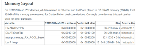

Have you tried using this memory configuration?
With regards,
