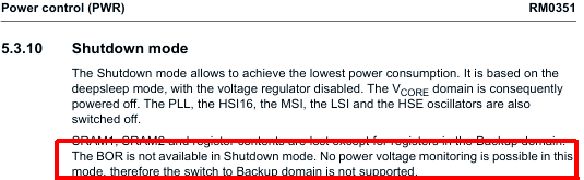

While I was experimenting with the 'L476 Disco, the RM wording goes across multiple families, so it may be relevant to most/all of them.
In particular, for Shutdown mode (which is supposedly the lowest-VDD-consumption mode), the RM says:
What does "switch to Backup domain is not supported" mean, exactly (assuming VDD and VBAT have separate sources)?
  1. as soon as Shutdown mode is entered, RTC (backup domain) is switched to VBAT even if VDD is present, potentially draining the VBAT source (battery, capacitor)
  2. in Shutdown, while VDD is present, RTC is powered from VDD; but when VDD is removed, RTC is *not* switched to VBAT, resulting in backup-domain reset and/or RTC corruption
  3. in Shutdown, while VDD is present, RTC is powered from VDD; but when VDD is removed, most of the time the switch flips to VBAT as expected, but this is not reliable and sometimes RTC corruption occurs
  4. in Shutdown, it's unpredictible, what is the backup-domain switch state, even while VDD is present
These are very different scenarios and it's important to know, which one of them is valid, to be able to plan the lowest power consumption mode properly.
Can ST please comment.
Thanks,
Viktor POHORELY

Hello @waclawek.jan
The switch to VBAT and back is handled by the voltage monitoring system. However, this system is disabled in Shutdown mode in order to reduce power consumption by removing the current drawn by the voltage reference.
Since this block is responsible for the switch, and it is not available in Shutdown mode, VDD remains the supply voltage and no switch to VBAT is performed.
Hope that helps!
Gyessine

Hello Jan, let me join this discussion.
From your scenarios, number 3 is closest to the device behavior.
RTC supply is connected by switch to either VDD, or VBAT. This switch is controlled by voltage monitoring to ensure it is switched before VDD drops too low, below the minimum voltage needed by RTC circuitry.
In shutdown, there is no voltage monitoring to reduce consumption.
As voltage monitoring is not supported under shutdown, obviously all functionalities depending on voltage monitoring are not supported either. Device stays supplied from VDD, which MUST be stable because any drop in VDD may corrupt internal registers which are supposed to be kept.
Thus, we DO NOT guarantee correct operation of circuits under VBAT supply when VDD is lost during shut down.
It does not mean they will not operate somehow, even without clearly visible impact on test bench. Most likely, they will - as control switches are supplied from VDD, once VDD goes to short circuit, low level will appear on those switches and it will most probably lead to switch to VBAT.
However, it may happen below the minimum supply voltage required by those circuits and their content might be corrupted during this switch. It may not be visible on some samples, it may not be visible on some test scenarios, but risk is present here => functionality with no guaranteed behavior must be considered as not supported.
Obviously, customer may use and rely on undocumented behavior or unsupported functionalities ON THEIR RISK ONLY.
I hope it clarifies a bit device functionality.
waclawek.jan
Hi @Viktor POHORELY ,
Thanks for chiming in with the details.
I'm not suggesting to use undocumented behaviour. However, the documentation as it is now is IMHO not entirely clear in what the behaviour exactly is. For example, in the same SHUTDOWN chapter, the following sentence
was what made me to wonder, why my observations were different from "*will* be lost", prompting me to make this post at all and come up with the 4 scenarios.
Also, in "the switch is not supported", if "switch" is a noun rather than verb, this could be interpreted also as "all control to the switch is lost [in SHUTDOWN mode]", implying behaviour 4 (i.e. no guarantees for backup domain in SHUTDOWN). You argue, that "as control switches are supplied from VDD", but I'm not sure this information follows unambiguously from the available documentation.
So, if the real behaviour is 3, that would mean, that as long as VDD remains above its lowest boundary (1.8V, is it?(*)), in SHUTDOWN mode, there are two guarantees: 1. that RTC (and anything else belonging to Backup power domain) remains operational and under VDD power; and 2. that there's no current drawn from VBAT. And then there are zero guarantees for behaviour when VDD gets below that boundary. Correct?
Thanks again,
Jan
(*) or whatever is the datasheet value for given STM32 model -- I presume the behaviour we are discussing here applies to all 'L4/'L5/'U0/'U3/'U5 and maybe more.
PS. To be absolutely clear, I am not suggesting changes in documentation. This clarification is all that suffices.
