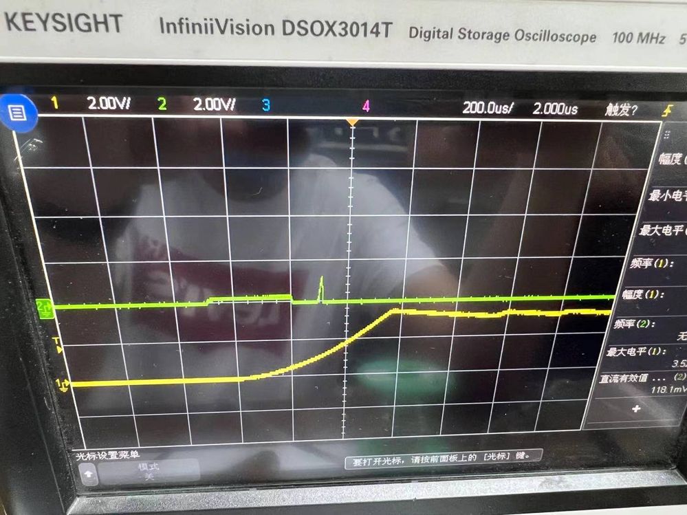

The chip is STM32G491. The NRST pin is suspended. The option byte is default value.
I find my board doesn't work after power up, so I measure the waveform of VDD and NRST as figure 1 below.
0693W00000KbRRNQA3.jpgFigure 1
The green wave is NRST and the yellow wave is VDD. The peak of NRST is 1.7V which is the POR threshold of BOR circuitry.

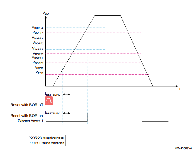

BOR circuitry will reset the chip until the VDD voltage is above the POR threshold, and then release reset after tRSTTEMPO.
0693W00000KbRZcQAN.png0693W00000KbRatQAF.png0693W00000KbRbIQAV.pngBut the chip still remain reset actually in the waveform. The rise time of VDD is about 500us from 0v to 3.3v.

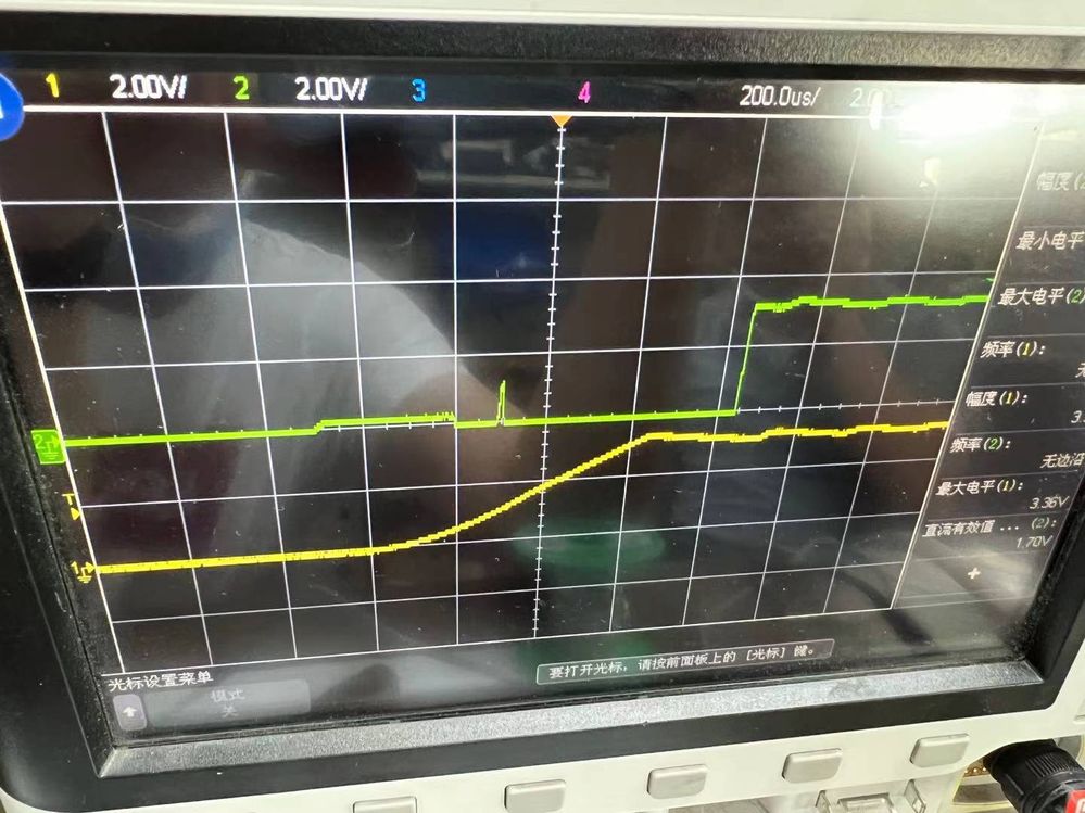

I change the power supply which have a larger capacitance. So more rise time is needed of VDD. Other experimental conditions are the same and I measure the waveform as below.
0693W00000KbRdTQAV.jpgFigure 2
It can be seen that the reset is released after about 450us, and the rise time of VDD is over 600us. The chip can work well now.
By constantly changing the power supply and adjusting the voltage rise time, I find that the chip will remain reset if the rise time is less than 600us.

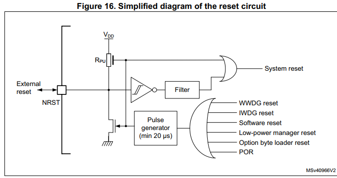

My project is use NRST-pin as a GPIO so there is no pull-up resistor or pull-down capacitor.
