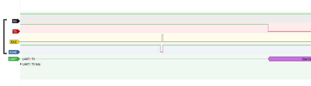

I think i have the same problem, i'm using a STM32F103RB device. Here's the capture of the LA i'm using:
Right before enabling the IDLE interrupt i toggle the RXNE pin (this result on the falling edge), then i enable the IDLE interrupt which results on the IDLE signal to get high, and then i toggle the RXNE pin again (this results on the rising edge of the RXNE signal).
I solved it clearing the flag before enabling the interrupt, i stepped in the code and the IDLE flag on the Status Register is asserted when i enabled the IDLE interrupt so the interrupt handler was called before even setting the reception interrupt (in my case). This is the way i solved it:
__HAL_UART_CLEAR_IDLEFLAG(&HM_HANDLE);
__HAL_UART_ENABLE_IT(&HM_HANDLE, UART_IT_IDLE);�?�?
