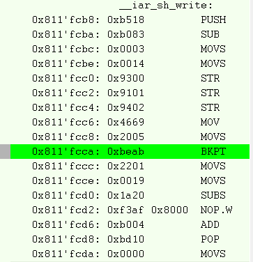

I tried redirecting fpintf to SD card. I found templates for file operation in \IAR Systems\Embedded Workbench 9.0\arm\src\lib\file.
Implemented __open/__close/__write/__read/__/lseek. When running code in IAR debug mode, the execution trapped using BKPT instruction. Seems the IDE is semi-hosting.

‎2022-09-08 1:10 PM
Just select a non-minimal variant of the IAR runtime library, that uses file handles (or descriptors).
Do not select semihosting, of course.
Then your _write replacement will receive the file handle/descriptor number.
Send the data for different descriptors to different destinations, as you like. Values 1 and 2 are stdout and stderr.

I can redirect to both UART and SD Card using "Full" Library Configuration. I had to disable "Buffered terminal output" in IAR. In addition to own implementation of __open/__close/__write/__read/__/lseek, putchar and getchar needs modification to call to UART TX & RX functions.
