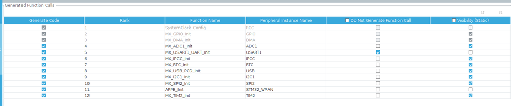

Struggling with an issue with the WB55. I'm attempting to see BLE stack debugging through the UART. I've tested the redirect without WPAN being enabled and found the hardware is functional. When I enable WPAN debugging, redirect function is never called.

Setting up the debugging for WPAN has been done to setup guide:
MX_USART1_UART_Init() isn't called in the main() function but called in the DbgOutputInit() function:

‎2023-08-01 12:29 AM - edited ‎2023-08-01 12:32 AM
Success! Queue and hw_huart needs to be initialized. This can be done by calling:
/* USER CODE BEGIN APPE_Init_1 */
APPD_Init();
/* USER CODE END APPE_Init_1 */
