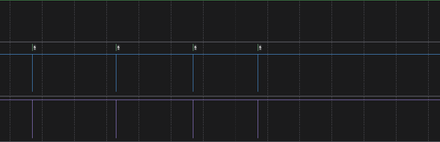

1. I did use a logic analyzer and start condition is in fact not generated (line stays at logic 1)

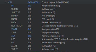

Show a screenshot of the I2C registers when the error occurs. Probably missing something in there. Note that BUSY can cause this behavior.

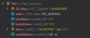

Here is the TWI1 object I am using:
As we can see, the state switched to TWI_SENDING, which should mean start condition was sent but as we can see on the logic analizer, fifth start condition is never sent.

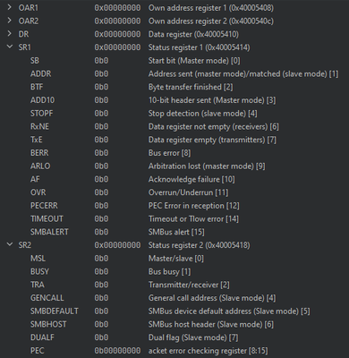

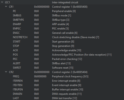

Here are the registers:
Your register output shows all 0s in the I2C1 registers. The peripheral is not even enabled, it's certainly not going to send a start condition.
I also do not see CR1_START high like you say it is in the first post.
Looks like you have a modified HAL-like structure. You should be initializing the peripheral in a manner similar to HAL_I2C_Init. The values in the software state handle are not what matters; ultimately the registers dictate how the peripheral behaves.
I know that, I didn't notice PE was 0, but I can ensure that I don't set it to 0 manually, I have no clue how is it turning to 0. I am also not using pointers directly in this program.
waclawek.jan
You do that in resetTWI() --> LL_I2C_EnableReset(), indirectly, by setting SWRST.
After that, you would need to reinitialize the whole I2C machine.
However, the primary problem is that you call resetTWI() at all, so you should investigate there.
