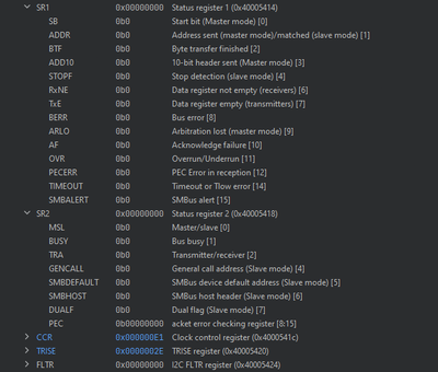

I am trying to use stm32F446 as a master I2C device with LL library and I have 2 main issues.
1. After sending a couple of messages(always 4 at most) over I2C I get no start condition when setting CR1->START, if I pause the program a couple of seconds later and I inspect the register it is still at 1 and never goes back to 0.
2.I randomly get interrupts on both (Don't know if both at the same time) EVT and ERR with none of the EVT or ERR flags set.

Is the BUSY bit set in the status register? If so you will have to clear it before it will send out a start signal.
No, here are the registers AFTER the start bit wasn't generated:
But that's after the timeout, isn't it. If there was some error/status flag, it would have been already cleared by the error interrupt, wouldn't it.
At this point, I would also ask, what exactly is connected and how, and whether signal integrity of the bus is perfect or not that much so (that involves track length, capacitance, pullups, neighbouring tracks with potential crosstalk, and all aspects of ground arrangement).
In my experience, the v1 I2C in 'F4 has a flaw (unacknowledged by ST, so take this with a huge grain of salt) in that due to unexpected interference on the bus it can get stuck amidst communication without any indication (my guess is, that this is due to flawed multimaster-related logic (I've seen that on non-ST chips in the past, unacknowledged by that manufacturer either), but I have no proof and I don't have insider information on the I2C internal machine to draw definitive conclusions). So, if the answer of the above question is "no, I am not 100% sure about signal integrity, as my tracks are not very short, pullups are weak, ground is not that great, and there are sources of interference nearby", you definitively need the timeout to bail out, but you should primarily focus on improving that signal integrity.

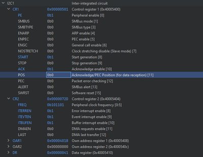

OAR1 = 0x4018 is interesting. Since it's a master, why is this register modified? The highest bit set is in a "reserved" section of the register. Not sure if it's relevant.
Putting a logic analyzer on the SDA/SCL lines would provide some insight.
While it is true that status registers' were cleared if an error occured, this is not the case, since in case of errors I change the state variable in my struct, and that didn't happen. It has the value it takes when START bit is set on CR1
> Signal integrity is not perfect. It is a breadboard, so tracks are short. But I did check and GNDs are 0.3v apart.
Reducing pullup resistors also semmed to help. Will take this in consideration for the final product but still check for errors just in case and reset the interface I guess
I did check SDA/SCL lines. All messages are sent correctly until this error happens (And start bit isn't sent).
OAR1 is modified because it has a random slave address I set on CubeMX
