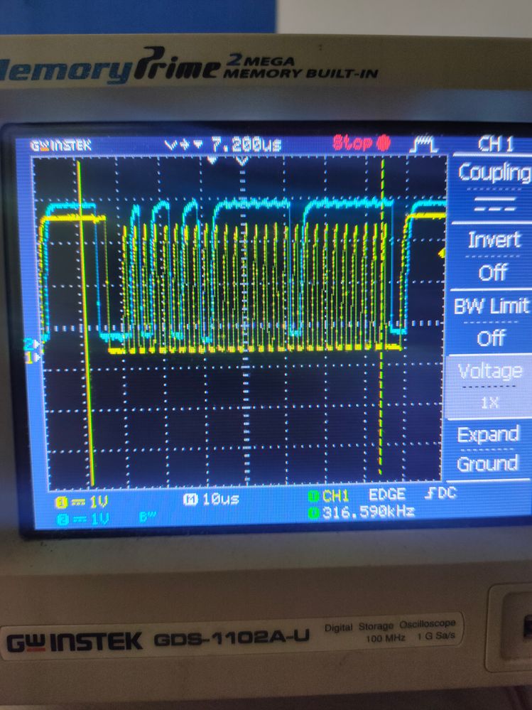

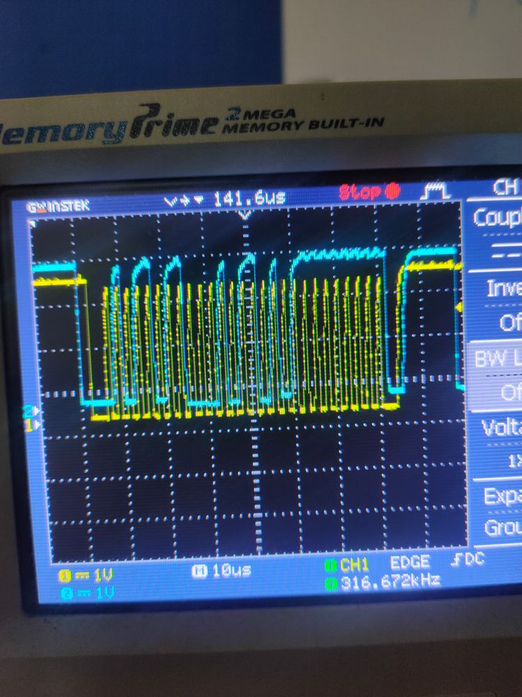

Hello All.
I am trying to establish an I2C communication between STM32F091VCT6 which is configured as a slave and another controller as a master.
I am trying to send data in blocking mode and facing certain issues. I am able to verify an address acknowledgement from stm and able to send a test 1 value data.
I see an issue while transmitting multiple data in a buffer. Using breakpoints, I can see that the code is stuck checking TXIS flag, which never seems to be set and eventually gets timed out.
Any support will be helpful.

2020-09-16 4:57 AM
SDA and SCL lines- 1st image single data and 2nd image buffered data
