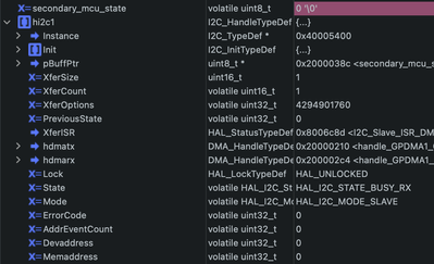

What I find curious is that after having started HAL_I2C_Slave_Receive_DMA() and then stepping through the while loop code, the program acts as desired: The LED is changing color continuously, and the i2c handler mode is appropriately set to HAL_I2C_MODE_SLAVE:

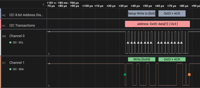

Here's a look at the scope, which also shows that the I2C writes from the master device is neatly ACKed:

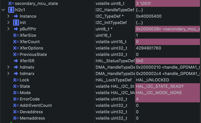

As I start running the program without breakpoints, the handler mode immediately jumps into the state HAL_I2C_MODE_NONE, and the device stops receiving data from the master. See below:

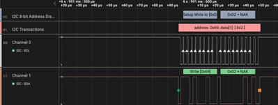

Scope now shows the data sent from master being NAKed instead:
