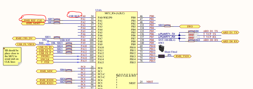

I am using "NUCLEO-H743Zi2" eval board. I am using it for UART communication. I had configured UART4 in it as following;
  • PA0 as UART4_TX
  • PA1 as UART4_RX
When I tried to transmit, it is not transmitting more than 2 bytes. While receiving, it is not at all consistent (random values are received).

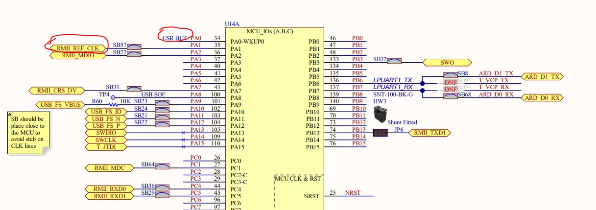

So I checked board's schematic as following;
I saw that PA1 and PA0 are not directly connected to CN11 connector in the board.
Is it causing UART4's transmission and reception error?
Also if I want to operate UART4 using GPIO's PA0 and PA1 only, what is the solution?

You need at least to remove SB57.
Seems your UART is disturbed by the clock coming from ETH PHY.
Thank you for replying.
I understood that for PA1 (rx pin) I might have to desolder SB57.
But what might be problem in PA0 (tx pin)?
Before going further, you can test with another alternate function not mapped on PA0 even it will not be your final design and check if the problem persist.
