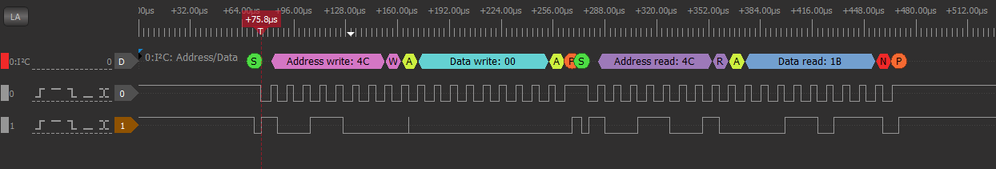

And my first call this function is OK:

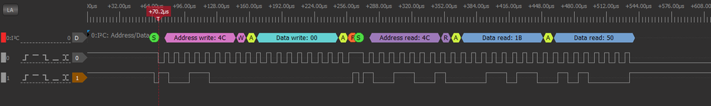

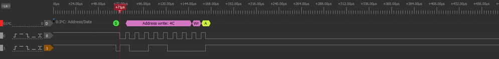

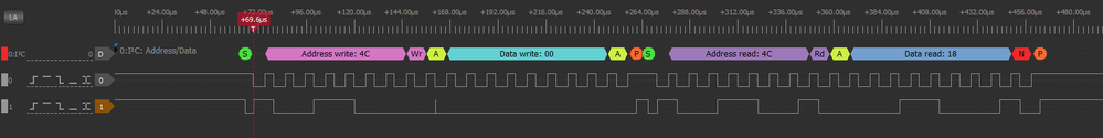

But second read from device is wrong.
Any idea, what is wrong?

‎2018-03-01 1:58 AM
The device can't perform stop while SCK is held down (see your waveform for case 2).
As the status register is read during communication, store its changing value into an array, so that you have the whole history; then compare 'good' with 'bad'.
