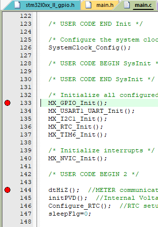

    Takayoshi Ishii
    March 1, 2018
    Posted on March 01, 2018 at 03:16
    Hello, thank you all!
    I made a custom board and I already have made over 10 custom board, but this is my first time to met this error.
    I use ST-Link that is from Nucleo board. I cut it and use just St-Link parts. SWD connection.
    I checked ST-Link Utility, the version was v2,J28,M17  and I updated it to v2,J28,M18.
    My program don't use any sleep or stop mode.
    I was checking the hardware since last night, now 11 am, but now I doubt the software.
    This is my code. I can stop by line 133, can reset, can run again. If I put a break point at line 134, I can not stop the debugging, but my board works well... Line 133 to 140 is made by Cube-MX.

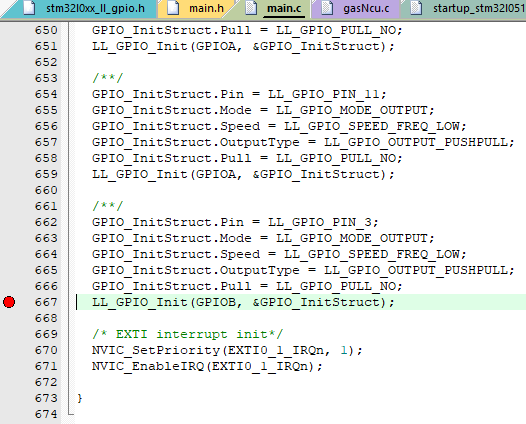

    This is in the MX_GPIO_Init(). I can stop line 667, almost last part of the function but If I step next, I can not stop the debugging...
    Takayoshi Ishii
    March 1, 2018
    Posted on March 01, 2018 at 03:47
    PB3 is connected to a FET gate. This is the same hardware design that I made already many times and working well except this project.
    When I disconnect PB3 and FET physically, I could stop the debugging. Why...???
    PA8 is also connecting to a FET gate and the MX setting code seems the same as PB3 setting. But PA8 doesn't have to disconnect, and I can stop the debugging...
    Tesla DeLorean
    Guru
    March 1, 2018
    Posted on March 01, 2018 at 04:04
    PB3 is the SWO pin of the debug interface, although not used on CM0/CM0+ devices to the best of my knowledge.
    AvaTar
    Senior III
    March 1, 2018
    Posted on March 01, 2018 at 08:32
    Perhaps does a reconfiguration of PB3 nonetheless affect the SWD functionality.
    I would try debugging with all code touching PB3 removed.
    Takayoshi Ishii
    March 1, 2018
    Posted on March 01, 2018 at 08:48
    Thank you Clive and Ava!
    I don't use SWO line but I should not use PB3.
    Thank you very much!
