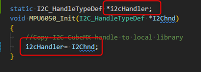

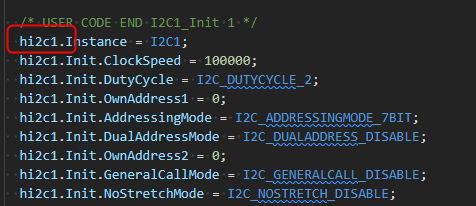

Finally found the solution. I summarise some issues I had:
HAL_I2C_Master_Transmit_DMA(i2cHandler, MPUADDR, i2cData, 2);
- The Deliverable data: The deliverable data must be global variable for DMA, otherwise when I am leaving the function/ or calling a destructor of the object the memory is freed and the DMA aburts.
- The delivery target in my case the i2cHandler must not be the copy of the original structure/objetc, because the callback function addresses are checked from parallel interrupts based on the original object and updated in the caling HAL_I2C_Master_Transmit_DMA function. If incorrect ending up in a loop in the HAL_I2C_EV_IRQHandler because teh hi2c->XferISR is alvais NULL.
What to check: If the I2C handler is exacly the same in the interrupt handler from the function or the name is different, but the new one only uses a pointer to the old one. In my case thy where not the same from the myin called hi2c1 and the function i2cHandler.
The solution for me was to use the copy of the pointer only not the contant of the hendler.3. With the STM32 H7 boards there is a memory allocation issue which is explaind with the solution in the below article.

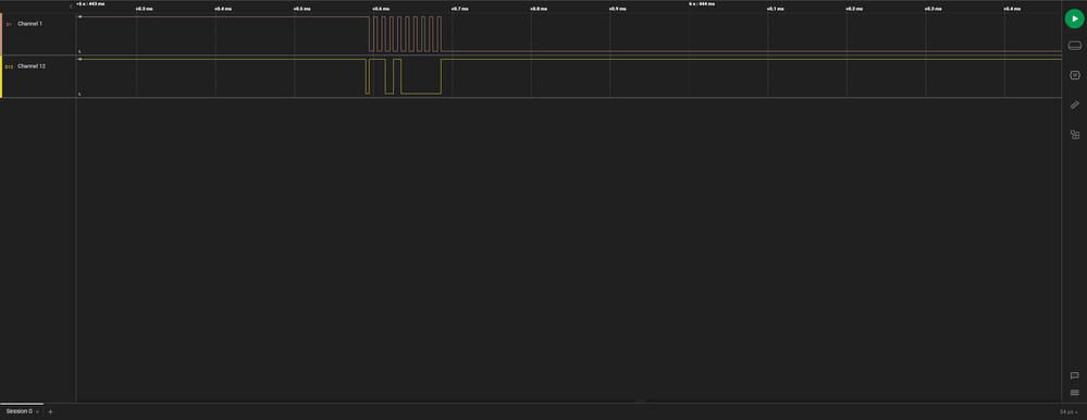

‎2023-02-08 7:59 AM
Hi @KHALSI_Foued​ ,
Thank you for your replay, i changed the Pull-up/Pull-down to Pull-up. But it did not helped unfortunately.
I attached a capture with a Logic analyser. I am trying to get the error flag status.
The I2C_DMAError function is not called. And from the registers the fault masks is 0.

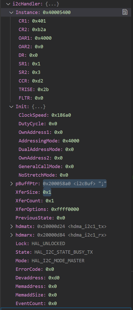

‎2023-02-09 10:41 AM
Hi @KHALSI_Foued​
I could only figure out the the state register remained HAL_I2C_STATE_BUSY_TX but everithing else looks fine to me.
Could you please have a look at on the registers if you can see something?

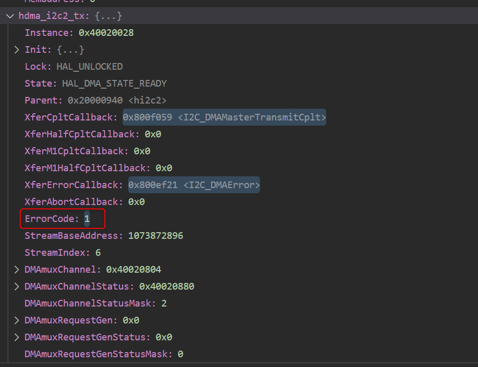

‎2023-02-11 9:56 AM
I Switch to a different device a Nucleo-H723ZG whwre at least the DMA transfer starts.
But happenes only for 1 cycle and the DMA failes with error code 1. What is the Transfer error.
#define HAL_DMA_ERROR_TE (0x00000001U) /*!< Transfer error */ My code now looks like this:

Could you please suggest what I am doing wrongly?
