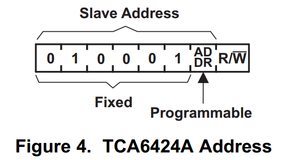

As you can see in figure 4 in TCA6424A datasheet, you need to use 8-bit address. one bit is for data direction bit (R/W). I think this is the only problem you have.
Hope this solution would be helpful.

Yes. you and Clive are right. As you can see in following picture, there is a software part for making the address R/W:
So you may need to shift your address one bit left.
Sorry for my last wrong post.
