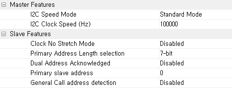

I2C peripheral has been initialized with STM32CubeMX according to the picture bellow:
I am using I2C1, pins B9 (data) and B8 (clock) in STM32F4 - Discovery. The device�s address is 0x60 (Says the datasheet). I am using pull-up (8 KOhm) and conflict protection resistors
(1.2 KOhm)

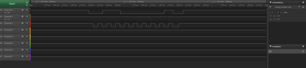

The next picture shows the activity in the I2C bus:

Using a scope, do you see the proper address on the bus ?
‎2017-12-20 7:38 AM
I am using an OV9655 camera module. I'll give a try with an EEPROM and I'll also consider changing to other pins. Thanks.
‎2017-12-20 8:08 AM
According to the image I attached, the address seems to be transmitted correctly: [start condition - 0110000 (address) - 0 (read operation) - 1 (Not Acknowledge) - stop condition]. But at the last clock pulse, data is high, what stands for a Not Acknowledge.
‎2017-12-20 8:30 AM
The lack of an ACK indicates nothing on the bus recognizes the address. Triple check the wiring and power for the slave peripheral you expect to respond. Check the address selection bits on devices that support that. Make sure the pins are in OD mode.
