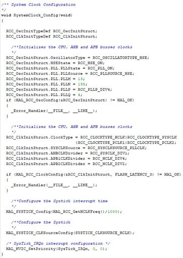

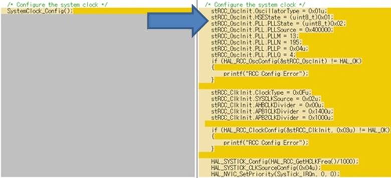

I am curious about the main.c file among the files generated by the stm32cubemx program.
I want to configure directly the system clock in the main function without calling the SystemClock_Config function in the main.c file.
Can I modify the non-user section in the main.c file? if I want to modify code as follows,
Is there any problem with copyright?
main() function in the main.c
SystemClock_Config() function generated by the stm32cubemx program(delete)
Regards, SJ

We can't use the GPL(General Public License). The STM32CubeF2 Data brief states that the HAL API is provided as an open source BSD license for user convenience. We used the Open Software License validation tool to examine the code I generated with STM32CubeF2. Unfortunately, the use of the GPL in the SystemClock_Config function in the main.c file was determined to be suspected. So I tried to change the code.
Posted on April 11, 2018 at 03:01
The same is true for _Error_Handler and assert_failed functions in main.c.
