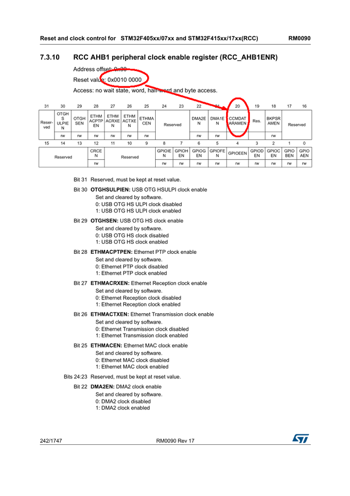

waclawek.jan
Do you mean STM32F407? In that, CCMRAM *is* enabled after reset:
0693W00000LyBtQQAV.pngso if you have problems with it, the source of those problems is something else (that's why adding initialization did not solve the problem).
"Stops/freezes" is not a helpful information. Debug as usually, start by observing in debugger, where is the program counter.

Hi waclawek.jan,
Thanks for the reply. I am using GCC (CubeIDE). My program prints a lot of messages after testing some portions of HW before going into an infinite loop to execute series of functions. As suggested by you, I will debug the code and see where the problem is. However I would like to mention here that the program works without any problem as long as the stack is set to RAM (original linker file). CCMRAM clock is not enabled at reset. It needs to be enabled in the code. Since I set the stack pointer to CCMRAM, I modified the assembly start up file to add the following before a call is executed. The code started working after I enabled the clock. Also in the diagram you have posted, there seem to be some confusion. as per the binary value shown there the bit to enable CCMRAM clock is BIT 5 but it is actually bit 20 in the register. Here is the code I wrote
 ldr  r0, =0x40023830
 ldr  r2, [r0]
 orr  r2, (1 << 20)   //0x100000 // set bit 20.
 str  r2, [r0]    //                1  0  0  0  0  0
/* Call the clock system intitialization function.*/
 bl SystemInit   // this is the first call.
