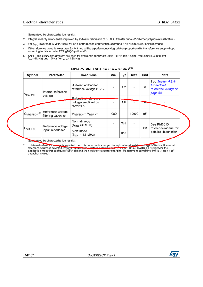

I use STM32F373VCT6. I use all 3 of its embedded SDADCs with external Reference of 3V. I am wondering what would be the current requirement (output current of the REF device) I should be looking for when selecting the Ext. REF.
