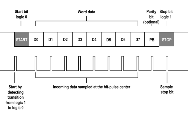

What does data transmission with and without parity bit look like in UART?
MMust.5
Senior II
For example, I use 8 bit data transfer type.
There are 3 types for the parity bit in total
No parity
Even parity
Odd parity
Even parity
I'll make an assumption that Even parity looks like this:
10011100
The first 1 from the left is the parity bit.
If the parity bit is enabled in the settings, but it does not need to be set, because the number of transmitted bits is even, should it look like this?
00111100
Odd parity
For Odd parity looks like this?
10001100
If the parity bit is enabled in the settings, but it does not need to be set, because the number of transmitted bits is odd, should it look like this?
00011100
No parity
If No parity is enabled in the settings, is the parity bit excluded from data transmission?
At first 8 bits were transmitted, but when I turn off the parity bit, will 7 bits be transmitted?
Or will 8 bits be transmitted, but instead of a parity bit there will be zero?
If so, is one bit wasted in data transfer that is not used?
The parity is the last bit sent, followed by the STOP bits, which provided for an intersymbol gap
In STM32 peripherals, the parity is counted as a bit, so 8E1 would be 9-Bit Including Parity
Line normally HIGH
START BIT (LOW)
BIT 0
BIT 1
BIT 2
BIT 3
BIT 4
BIT 5
BIT 6
BIT 7
PARITY BIT (making HIGH bit counts in total ODD or EVEN)
STOP BIT(S) (HIGH)
Line Continues Normally High, or you see the NEXT Start Bit

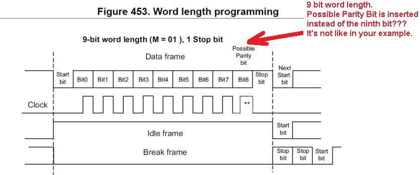

Ok. Understood. It seemed to me earlier that the parity bit is part of the 8 bits of data that are transmitted.
>>..is part of the 8 bits of data that are transmitted
Well in ST's case if you set 8-bit mode and even parity, everyone else would call that 7E1
ST generates the parity bit on transmission.
On reception you need to strip it from the UART->DR / RDR with a mask, as the 16-bit register will have the parity bit present. If you cast it into an uint8_t it will obviously be lost, in the 8E1/8O1 cases, but just keep it in mind if you carry it with a 16 or 32-bit variable.
Above, Paul@Port wrote:
8E2 == sBBBBBBBBPSS
8 bit mode BBBBBBBB
Even parity mode.
You write that with eight bits and Even parity mode, this is 7E1
I'd have to say that ST isn't following "industry norm" if that's how they named it. In my all too many decades the numeric was the number of data bits and the parity was separate, that for all the different MCUs I used before ST.
Apologies if my explanation clashes with ST docs, that probably follows how the silicon was implemented.
Personally I avoid Parity where possible and use much more reliable CRC's.
Paul
This picture contradicts what you wrote, as it seems to me.
Here the Possible Parity Bit is inserted in place of the ninth bit of the transmitted data?
In your example, the Possible Parity Bit is inserted AFTER the ninth bit of the transmitted data.
8E2sBBBBBBBBPSS
I took 8 bit mods as an example. In your example, there was no 9 bit mod.
