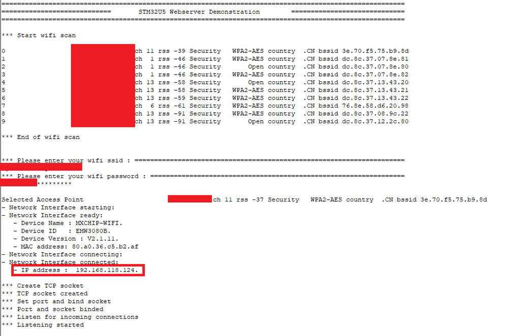

I purchased the STM32U5’s B-U585I-IOT02A evaluation board and trying to bring up default demo of webserver. I get the IP address but when I am trying to connect and open webpage it is not opening. Can anyone help?

Hello @tCHAP.1​ ,
I ran the example under this path:
STM32Cube_FW_U5_V1.1.1\Projects\B-U585I-IOT02A\Demonstrations\IOT_HTTP_WebServer\STM32CubeIDE
I did the following:
  • Open the project with CubeIDE
  • download the code to the target which is STM32U5 IOT board
  • Open a terminal with this set-up:
    • Baud rate : 115200
    • Stop bit : 1
    • Parity : none
  • Connect to the WiFi network listed in the terminal(as shown in the screenshot)
  • An IP address will be created for your device as shown in the screenshot
  • put the IP address in the web browser URL,then the web page will appear
0693W00000SuXIMQA3.pngAs a terminal I used Hercules

Hello @tCHAP.1​,
You need to be connected at the same wifi from where the IOT board is connected to, otherwise you can't open the web page with the provided IP address.
Mohamed Aymen
Thanks for your reply. For sure my other device is also connected to same AP. In fact I can ping to the module. It’s just that webpage not opening. I’m surprised that no one else has faced this issue.
