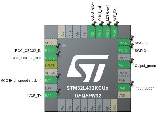

I need a green LED that blinks from 0ms to 3000ms,
a yellow LED that blinks from 2000ms to 3000ms and 5000ms to 6000ms and
a green LED that blinks from 3000ms to 5000ms.
I´ve made a working code using HAL_Delay but I need to use HAL_GetTick() so that I can implement an out-of-order state whenever a push-button is pressed.

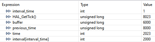

Down below is a code but the loop is messed up after it successfully runs the loop once using HAL_GetTick().

Using the STM32CubeIDE debug function I noticed that starting with the 2nd loop either the variable "time" is buggy or the if(time == ***) loops get ignored. In the example below "interval_time" should be 2 after "time" hits 2000.
_legacyfs_online_stmicro_images_0693W000008zsNN.png I`m using the STM32-L432KC and the pin setup is as follows.

Fix:
  while (1) {
    time = HAL_GetTick() - buffer;
    if (HAL_GetTick() - previous_time == interval[interval_time])  {
     // if(HAL_GetTick() >= 6000 ) {
        previous_time = HAL_GetTick();
      if(time >= 0000 && time <= 0050 ) {
        HAL_GPIO_WritePin(GPIOB, GPIO_PIN_4, GPIO_PIN_SET);
        if(HAL_GPIO_ReadPin(GPIOB, GPIO_PIN_5) == 1) {
          HAL_GPIO_WritePin(GPIOB, GPIO_PIN_5, GPIO_PIN_RESET);
        interval_time = 1;
      if(time >= 1975 && time <= 2025 ) {
        HAL_GPIO_WritePin(GPIOB, GPIO_PIN_5, GPIO_PIN_SET);
        interval_time = 2;
      if(time >= 2975 && time <= 3025)  {
        HAL_GPIO_WritePin(GPIOB, GPIO_PIN_4, GPIO_PIN_RESET);
        HAL_GPIO_WritePin(GPIOA, GPIO_PIN_11, GPIO_PIN_SET);
        interval_time = 3;
      if(time >= 4975 && time <= 5025 ) {
        HAL_GPIO_WritePin(GPIOA, GPIO_PIN_11, GPIO_PIN_RESET);
        interval_time = 4;
     if(time >= 5975 && time <= 6025 ){
        interval_time = 0;
        if(HAL_GetTick() >= buffer)  {
        buffer += 6000;
