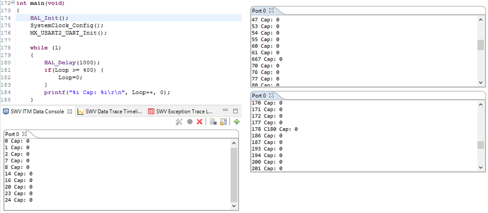

Help understanding mysterious lapses in printf() output via SWV Port 0 as shown in SWV ITM Data Console
Ted Jackson
Senior
0693W000008zqcuQAA.pngNotice how entire printf lines disappear and how occasionally just portions of printf lines disappear.

There are buffering issues within the pod
Even if I include fflush(stdiot); immediately after the printf, the problem is the same.
Well there are many layers that can cause this. From the ST-LINK firmware up to the host ST-LINK or OpenOCD server, to the CubeIDE (Eclipse) debugger client.
Has anybody seen these glitches with true J-Link adapters?
--pa
Presuming this is an ST-LINK?
Does fflush() have any plumbing?
You could try the SWV screen of STM32 Cube Programmer or ST-Link Utilities and see if that is more robust
As @Pavel A.​ notes there are a lot of moving parts here, a J-Link Ultra+ might work significantly better but we're in a whole different league there.
