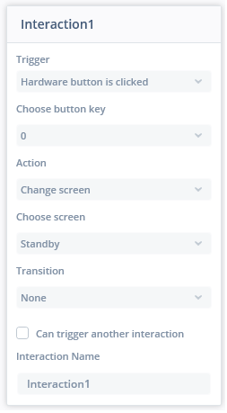

The idea is to create a singleton class in the common folder and use it. I was just wondering if this behavior could be achieved in some way with FrontendApplication.cpp
MBrau.7
If you create a screen via designer, the goto()-function is not automatically created.
To create the goto()-function for your "Service" screen in FrontendApplicationBase you need to
implement an interaction via designer where a screen change is triggered.
You could do something like this:

FrontendApplication& application = *static_cast<FrontendApplication*>(touchgfx::Application::getInstance());
application.gotoXYZScreenNoTransition();

for some reason, even if the view has been created with a name "service" the application().gotoserviceScreenNoTransition(); doesn't work as the code is not correctly generated in the FrontendApplicationBase
MBrau.7

Ah, it makes sense. I thought it would automatically generate it based on the view you created
