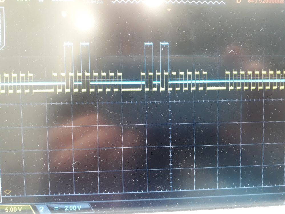

Hi JW, thanks for your reply. I'm using an stm32F769 processor. The HAL_SPI_Receive data and clock waveforms are shown below:

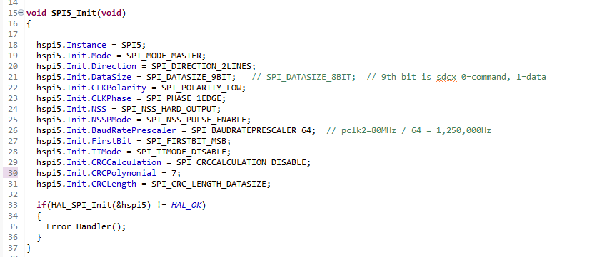

The SPI is set initialised as:

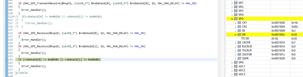

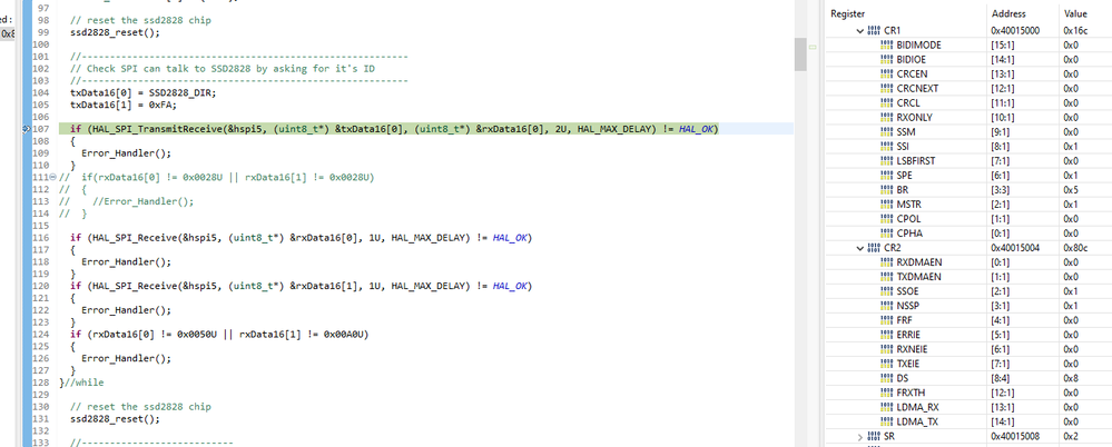

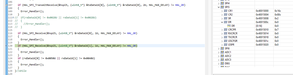

SPI registers:-After the 1st HAL_SPI_Receive()
After the 2nd HAL_SPI_Receive()The data I'm expecting to see for each 8 bit read is 0x28. The data I receive in rxData16[] is rxData16[0]=0x50 and rxData16[1]=0xA0 which appears to be 0x28 shifted to the left and shifted to the left twice for the second data read. Looking at the SPI DR register, I only see 0x50 appear after the second call to HAL_SPI_Receive().
0693W00000BdFHZQA3.jpgSPI initialisation:
