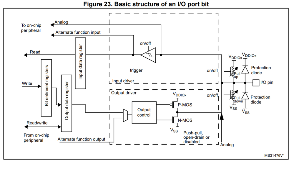

If this device is powered-down (i..e voltage is 0 on all rails), what impedance will be presented by the Port pins? If a pin from a powered-down STM32H743 is connected to a pin on another (fully powered) device, what current drain will occur?

when VDD is zero you may damage protection diodes:

Definitely a situation you should avoid.
The protection diodes are going to try to sink as much current as possible. They're either going to sink enough to bring the voltage down to 0.3V, or the diode is going to blow out. Or possibly the device will get backpowered. Not a test I want to run.

Look in the datasheet. FT pins are high impedance between 0 and 4 Volt .
Yeah, I was totally wrong on this. Apologies. Thanks for the correction @Uwe Bonnes.
I tested it on a board as well. PA0 sits happily at 3.3V while VDD=GND=0 with no ill effects. I didn't measure the drain, but I had it hooked up with a 10 kOhm resistor in series and it had a negligible voltage drop, so drain is much less than 1mA.

Zero current at any voltage (within given range) means high impedance.
