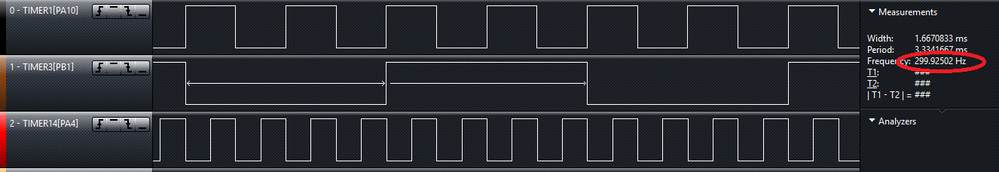

i try to Synchronization two timer together in master / slave mode
i have a problem when i enable another timer interrupt ,once of two sync timer freq was changed!!
you can see in my logic analyzer result
this is my code:

i use timer 1 & 3 in sync master /slave mode
and use another timer 14 for free running with interrupt
when i enable timer14 intteerupt ,timer 3 freq changed!!
this result when timer14 interrupt is disable:

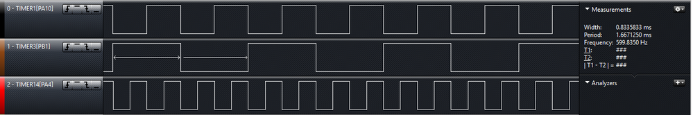

and this picture is when timer14 interrupt is enable:
you can see when interrupt enable for timer 14, freq timer 3 changed!!!
why this happened?
thnx for help

‎2020-01-09 11:20 PM
First, I never heard of STM32F040.
> TIM_SelectOutputTrigger(TIM1, TIM_TRGOSource_Update);
This generates a TRGO pulse upon TIM1 Update. The RM does not tell how long the pulse is, but I'd guess it's one internal timer clock long.
> TIM_SelectSlaveMode(TIM3, TIM_SlaveMode_Gated);
OK so you've set the TIM3 - which is clocked by the same internal clock - to be gated by that one-clock-long pulse. That is bound to go wrong, and that combination was never inteded to be used.
You may want to tell us, what do you want to achieve.
‎2020-01-11 4:13 PM
i want use timer 14 as free running timer with interrupt , and timer 1 & 3 in sync master slave mode
when i disable timer 14 interrupt, timer 1,3 work fine as master slave mode
but when i enable timer 14 interrupt you can see timer 3 frequency changed!
and i don't know why this happend
‎2020-01-11 9:09 PM
As I explained above, with the gated mode it worked only incidentally.
OK but what exactly do you want to achieve by having TIM1 and TIM3 as master-slave? Do you want to output some particular waveform on several pins? If yes, what waveform exactly? Do you want TIM3 to output half the TIM1 frequency? Then use External clock mode, instead of Gated mode.
