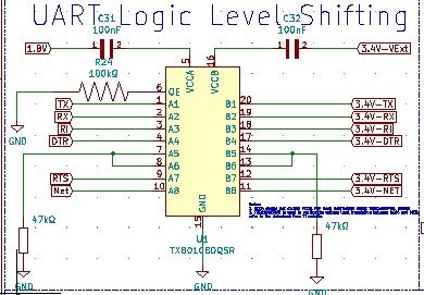

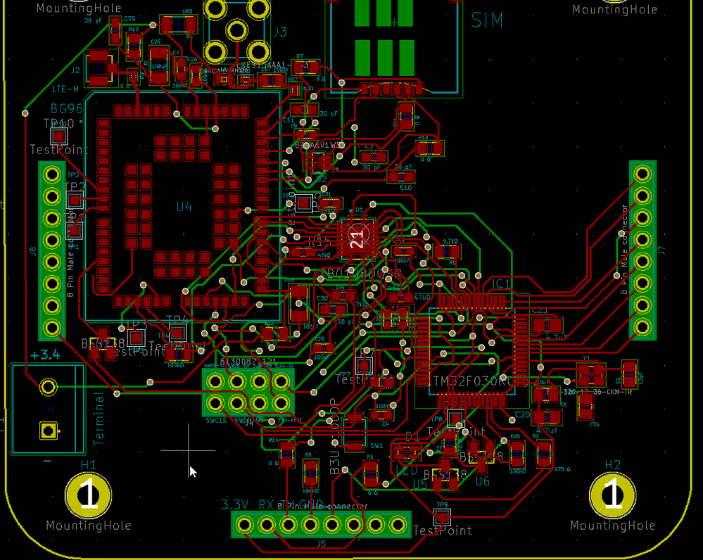

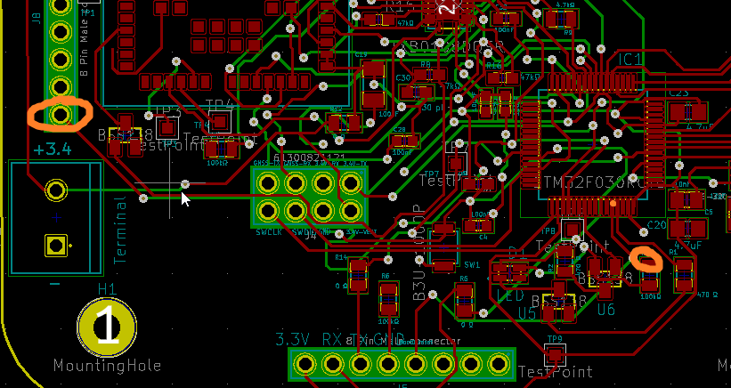

Hi guys, this is my first question on this community, I really did a lot of work on this pcb, I tried to make a custom made PCB board with the STM32F030RCT, So I tried to program the microcontroller with ST-LINKv2 programmer via SWD& SWDIO. I download the needed driver for the st-linkv2 but I still can not program the microcontroller, the output = 'Can not connect to target' using stm32CUBEIDE really tried everything to program it. I even tried the usb to uart cp2104 to program but even that did not work. All VCC are correct 3.3 Volts and there is no shortcircuit. I measured all VCC and the RST pin and boot0 pin and the capacitors are correct.

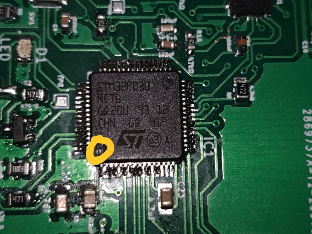

Make sure the part orientation is correct, Don't confuse ejector pin marks for pin 1 mark.
The external ST-LINK/V2 pod needs power on Pin 1 or 2 for the buffer logic.
The secondary signs-of-life method is to have BOOT0 High, and send an 0x7F data pattern at 9600 8E1 (Even Parity) and observe a 0x79 response.
Use RealTerm in Hex mode, and look at AN2606 for pins used by the boot loader.

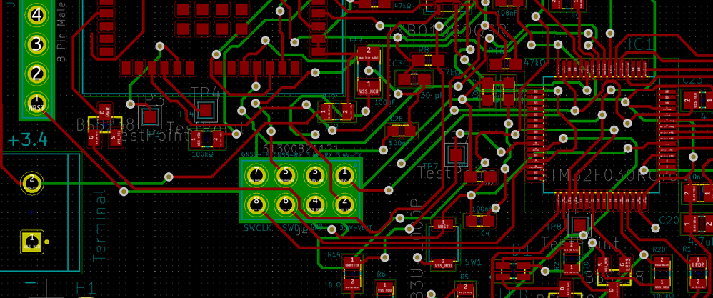

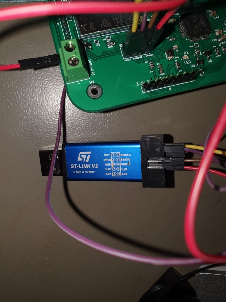

The first signs-of-life methode1 : Pin 1 is marked here, is this right? The datasheet was bit confusing but this seems right to me? This seems to be right, I connected the 3.3V and GND as shown in the picture, also the SWDIO and SWCLK and reset pin.

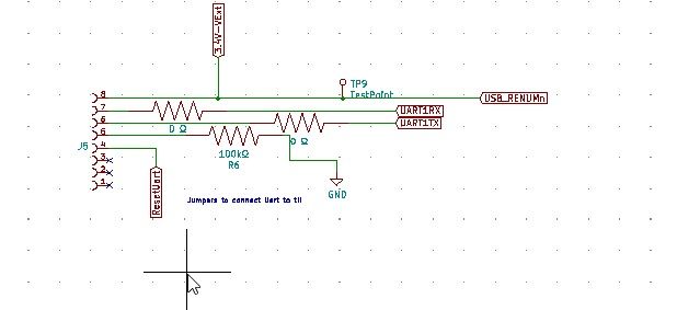

The secondary signs-of-life methode2: Yes I did switches the BOOT0 pin to 3.3 Volts (see schematic label ResetUART). I measured the boot0 pin and its perfectly high if I place the jumper , if I remove the jumper it goes to zero volts for the SWDIO and SWD programming mode like in methode 1. So after downloading software and opening flash loader demonstrator , the responder does not connect on any bautrate or any parity mode, so I cant even connect it from the flash loader demonstrator. 0690X00000BvoCeQAJ.jpg0690X00000BvoCKQAZ.png

Ok, so chip doesn't seem to be functioning. Pin 1 looks to be correctly orientated.
Still most probably pins and/or power
The crystal isn't important for the ST-LINK or USART methods.
Check the state of the NRST pin, if it is always low, check the VDDA

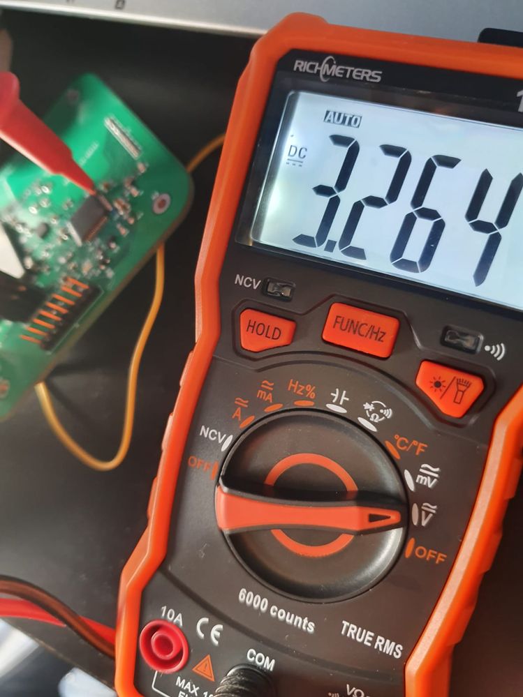

@Community member​ VDDA status as shown on figure.
