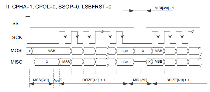

- You declares NSSPMode to SPI_NSS_PULSE_ENABLE. This mode is activated by the SSOM bit in the SPIx_CR2 register. For SSOM = 1, SPI data frames are interleaved with SS non active pulses when MIDI[3:0]>1. That's explaining the behavior of your SPI4 CS line. According to RM0433, we are in a situation quite similar as shown in figure 620.
Can you change to SPI_NSS_PULSE_DISABLE ? Does that solve your issue ?

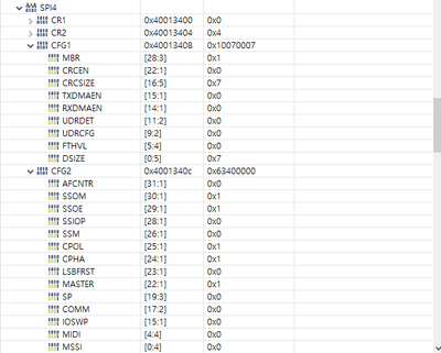

- Also, do you have the values of registers ? SPI_CFG1 ? SPI_CFG2 (especially SSOE, SSOM & SSM) ? In master mode, the SS can be used either as an output or an input. As an input it can prevent a multi master bus collision, and as an output it can drive a slave select signal of a single slave. How many masters are on the bus ?

- These are the values for the registers that you required
- There are only one master on the bus 
