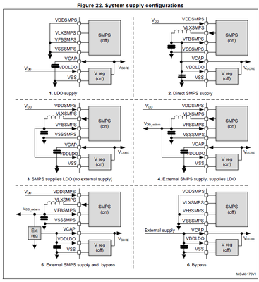

I am trying to upload Ardupilot to my board. The co-processor works just fine with the regular procudure but no matter how much I tried, could not get the firmware on MCU.
I have tried with the regular upload process documented on LINK  . However, even Windows 11 and ubuntu 22.04 do not seem to recognize the device. The output of lsusb shows no sign of a device while windows does not have any idea of its existence.
The board features STM32H75 as its MCU and STM32F301 as co-processor.
Please check the following:
1 - The hardware configuration of the STM32H755: LDO, SMPS or what else?
From RM0399:
The firmware configuration of the power should reflect the hardware.
2 - Did you enable any of the flash protection features in option bytes ?
From RM0399:
_CEVVAL
Yes, I found the problem. System supply configuration was wrong...
