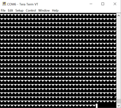

Hello STM32 Team.
I using uart1,3,6 setting for baud rate 115200,
Uart3 setting is it.
  huart3.Instance = USART3;
  huart3.Init.BaudRate = 115200;
  huart3.Init.WordLength = UART_WORDLENGTH_8B;
  huart3.Init.StopBits = UART_STOPBITS_1;
  huart3.Init.Parity = UART_PARITY_NONE;
  huart3.Init.Mode = UART_MODE_TX_RX;
  huart3.Init.HwFlowCtl = UART_HWCONTROL_NONE;
  huart3.Init.OverSampling = UART_OVERSAMPLING_16;
  if (HAL_UART_Init(&huart3) != HAL_OK)
    Error_Handler();
  HAL_UART_Receive_IT(&huart3,&rxd3,1);
HSI using Uart is it ok,
But, HSE 8Mhz crystal, broken uart message.
Only difference function "void SystemClock_Config(void)"
How can i fix it?
[Setting HSI]
Terminal Message [ok]

[Setting HSE]
Terminal message [broken]

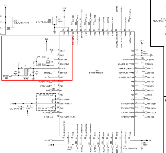

Include board schematic.
We are modifying and testing the circuit for the CTS RTS test of UART1.
UART6 is used as CTS RTS, and UART3 is used as USB output debugger.

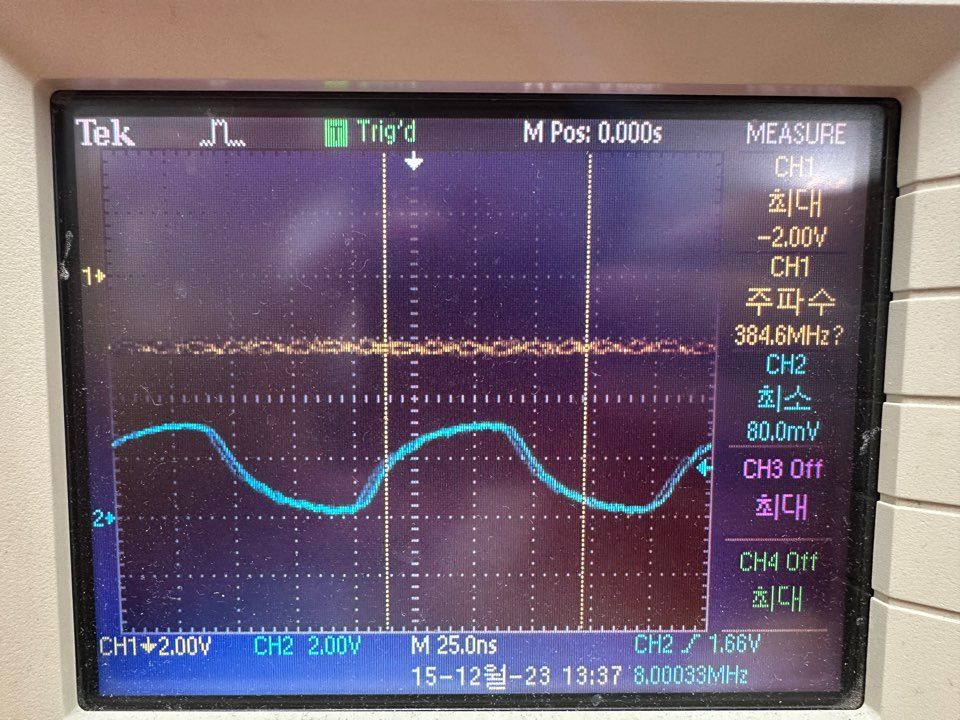

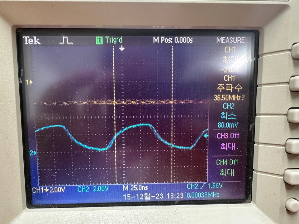

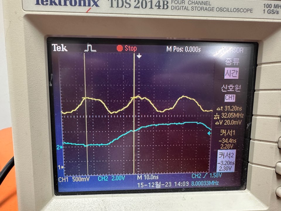

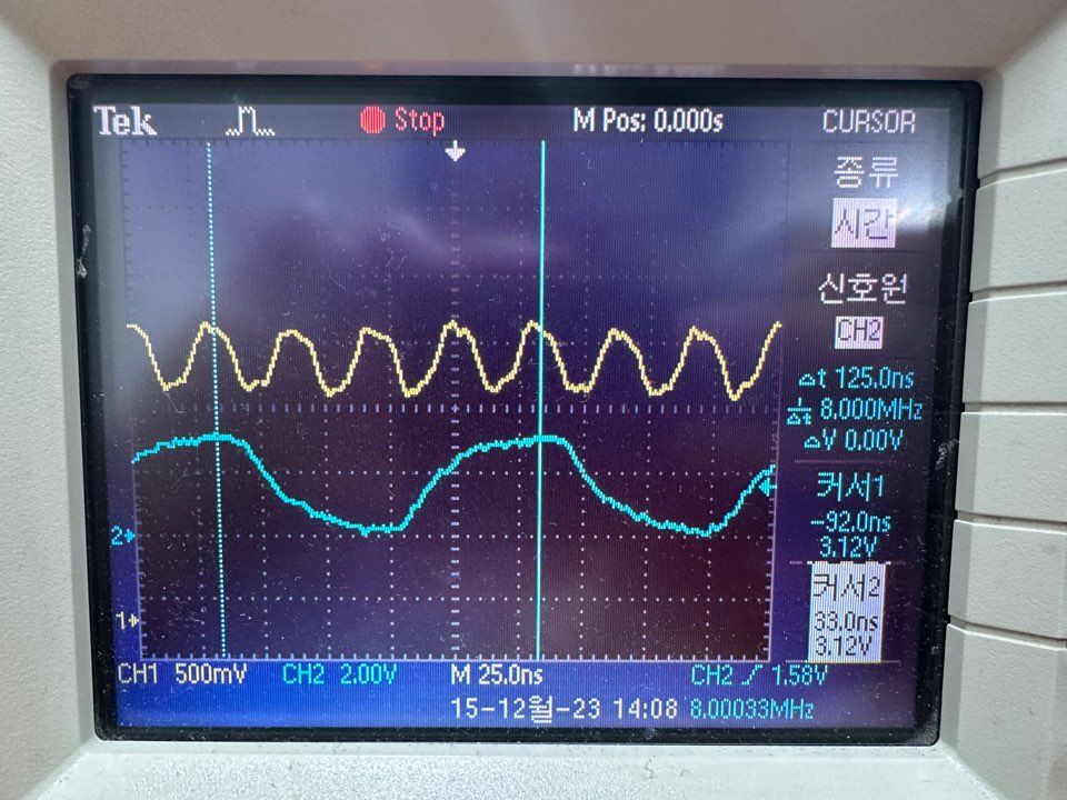

First try to output your system clock on MCO pin and check if you get your 36MHz. It could be something not good from your external crystal/resonator.
Like you said
I measured the following using an oscilloscope.
When in HSE mode, the frequency is abnormal as shown below.
[When in HSE mode = Abnormal (Fail)]
PA8(HSE), PC9 (SystemClock)
CH1 = System clock = PC9(System Clock)
CH2 = Crystal Clock = PA8(HSE) is 8Mhz
[When in HSI mode = Normal (Pass)]
CH1 = System clock = PC9(System Clock) is 15.96Mhz
CH2 = Crystal Clock = PA8(HSI) is 15.96Mhz
Below are photos and measured videos.
ch1_20231215_132418134.jpgch1_20231215_132418134_01.jpgch1_20231215_132418134_02.jpgch1_20231215_131716421_01.jpg

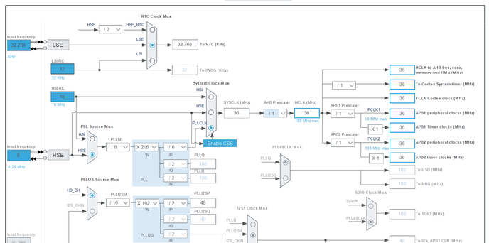

	// Configure the main internal regulator output voltage
	__HAL_RCC_PWR_CLK_ENABLE();
	__HAL_PWR_VOLTAGESCALING_CONFIG(PWR_REGULATOR_VOLTAGE_SCALE1);
	// Initializes the RCC Oscillators according to the specified parameters
	// in the RCC_OscInitTypeDef structure.
	//	HSE Cystal = 8Mhz
	//	SYSCLK = 36MHZ
	RCC_OscInitStruct.OscillatorType = RCC_OSCILLATORTYPE_HSE|RCC_OSCILLATORTYPE_LSE;
	RCC_OscInitStruct.HSEState = RCC_HSE_ON;
	RCC_OscInitStruct.LSEState = RCC_LSE_ON;
	RCC_OscInitStruct.PLL.PLLSource = RCC_PLLSOURCE_HSE;
	RCC_OscInitStruct.PLL.PLLM = 8;
	RCC_OscInitStruct.PLL.PLLN = 216;
	RCC_OscInitStruct.PLL.PLLP = RCC_PLLP_DIV6;
	RCC_OscInitStruct.PLL.PLLQ = 2;
	RCC_OscInitStruct.PLL.PLLR = 2;
		Error_Handler();
	// Initializes the CPU, AHB and APB buses clocks
	RCC_ClkInitStruct.APB1CLKDivider = RCC_HCLK_DIV1;
	RCC_ClkInitStruct.APB2CLKDivider = RCC_HCLK_DIV1;
	if (HAL_RCC_ClockConfig(&RCC_ClkInitStruct, FLASH_LATENCY_0) != HAL_OK)
		Error_Handler();
	HAL_RCC_MCOConfig(RCC_MCO1, RCC_MCO1SOURCE_HSE, RCC_MCODIV_1); //  PA8
	HAL_RCC_MCOConfig(RCC_MCO2, RCC_MCO2SOURCE_SYSCLK, RCC_MCODIV_1); // PC9

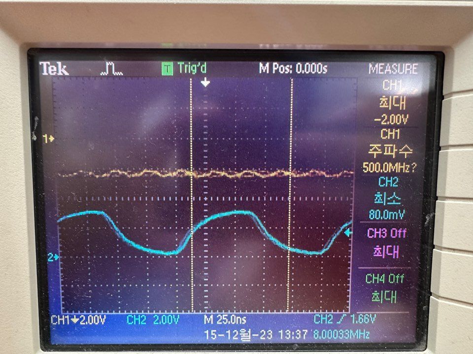

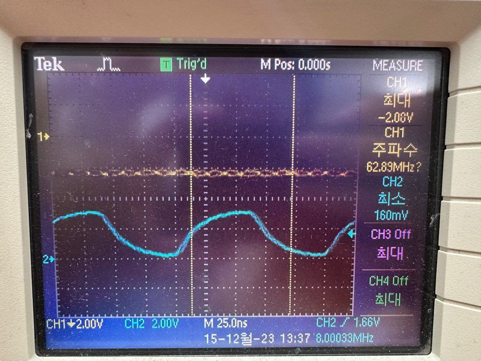

We don't care what Mhz the system clock is set to.
So I changed the settings as below.
HSE 8Mhz
System Clock 32Mhz
I confirmed with an oscilloscope that 32MHz was coming out.
The same broken phenomenon still occurs in UART.

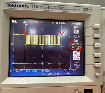

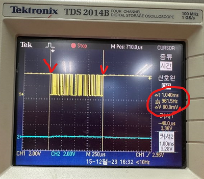

Test USART1 with an oscilloscope
I sent a sample message with Uart.
“Hello world!”
Just swap HSI and HSE.
HSI = 1.040ms / normally received
HSE = 3.240ms / Data corruption phenomenon
The difference between HSE and HSI is 3.11 times.
[Hello world! , HSE = 3.240ms]
[Hello world! , HSI = 3.240ms]
