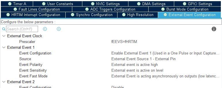

I'm trying to use the HRTIM TimerA on the STM32-G474 to generate a one pulse on TA1 output in response to an external event on hrtim_eev1.
I need the pulse to be generate with low latency and low jitter, but I'm not being able to get the Fast mode working.
I've configured external event 1 with level sensing and asynchronous action in CubeMX, but I continue getting high response time latency (>7 cycles of fHRTIM) and a response time jitter of 1 cycle of fHRTIM clock (5.8ns), instead of the minimum jitter I would expect. Also, pulse width has no jitter, as expected when FastMode is disabled.
I start the timer with the HAL_HRTIM_SimpleOnePulseStart function. Afterwards the EE1FAST register (HRTIM_Common->EECR1->EE1FAST) is 0.
I've tried to set it by hand, but with no results.

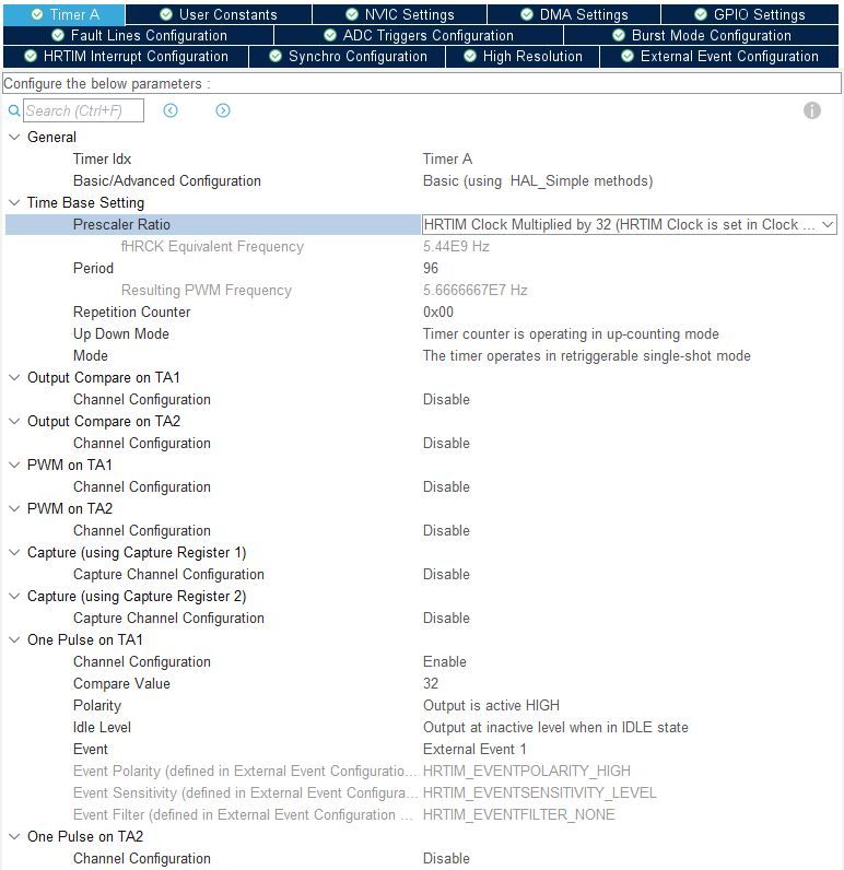

CubeMX settings are as follows:

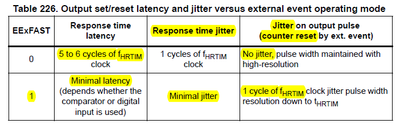

For "time jitter" I actually mean the "Response time jitter" (as in Table 226, pag. 877 of RM0440 Rev 8):
According to this table, the Response time jitter should be "minimal" in Fast mode (EExFAST=1). Instead I get a Response time jitter of 1 cycle of fHRTIM clock (5.8ns). It seems that FastMode is not being effective at all. I don't understand if CubeMX is not setting it properly...

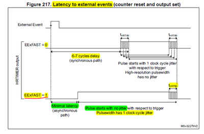

I would need to produce a pulse with minimal latency and no jitter as the one in the lower portion of Figure 217 (EExFAST=1), instead I get a pulse as EExFAST was 0:

After double check, I confirm the issue on my side, it has been reported to STM32CubeMX development team.
Internal ticket number: 183319 (This is an internal tracking number and is not accessible or usable by customers).
HAL_HRTIM_SimpleOnePulseChannelConfig function keeps the FastMode disactivated:
EventCfg.FastMode = HRTIM_EVENTFASTMODE_DISABLE;
However, I propose that you use the Advanced mode, Fast mode is well implemented.
