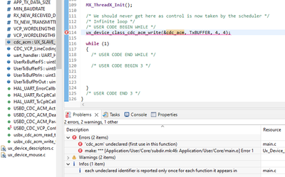

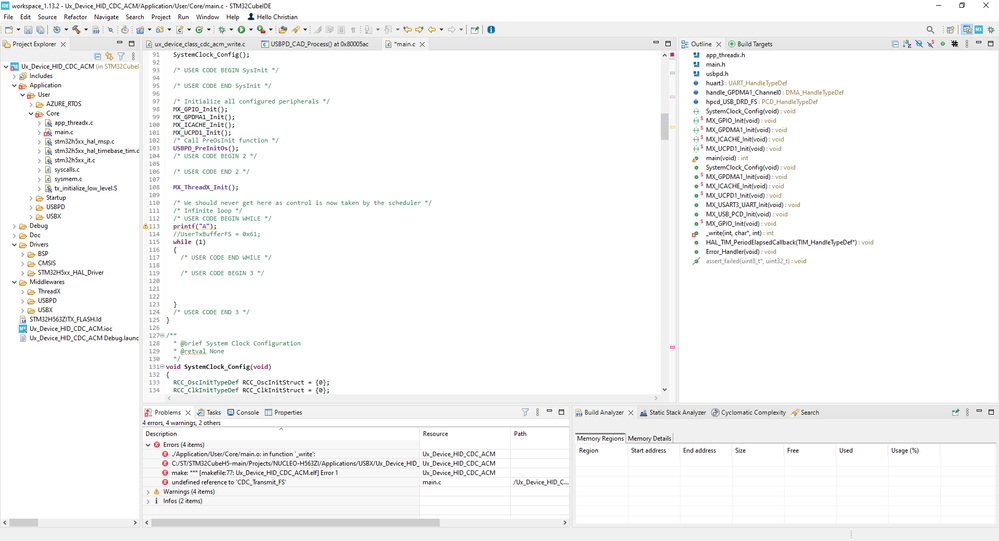

I insert you code in example in section /* USER CODE BEGIN 4 */
And call printf before while(1) with printf("A");
By building project I got 4 errors:
I hope you can read it.
CDC_Transmit_FS is undefined.

Thank you for your help! Ok new day new luck.
Sorry, I am a complete beginner.
I try to use the Function "ux_device_class_cdc_acm_write" in main.
I got an error that cdc_acm is undeclared.
Were I can find the adress or where I get the adress?
Do you know is there a documentation or an How to?
look at examples , like this:
https://github.com/Dbotelho2000/CDC_USBX_G474/blob/main/USBX/App/ux_device_cdc_acm.c
https://github.com/search?q=usbx%20cdc&type=repositories

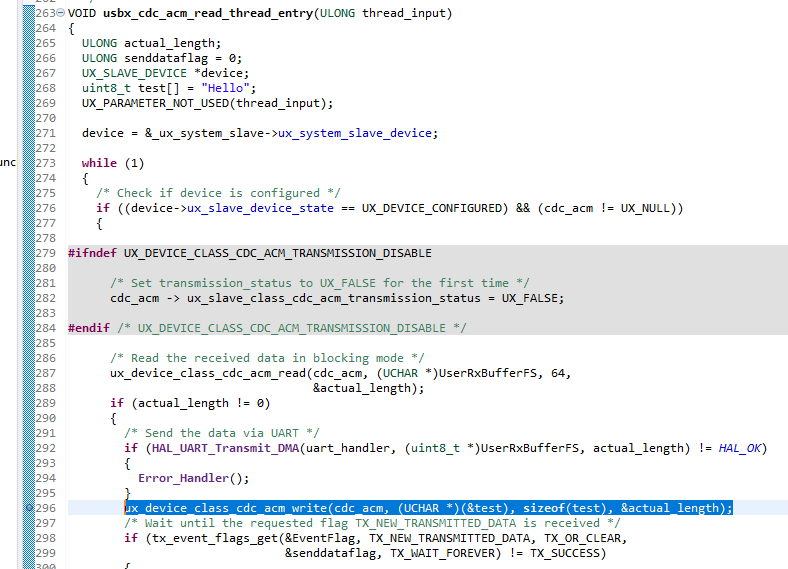

I want to send and receive customized data from my programm and from PC via virtual com port.
Thanks to @AScha.3, I found the function to send Data (ux_device_class_cdc_acm_write()).
But my fault was to call it in main.c
If I call it in ux_device_cdc_acm.c and it workin fine. Here my quick test:
I am happy to get this to work.
But is it possible to call the function in main.c or how can share data from main.c to ux_device_cdc_acm.c?
Maybe with global variables?
