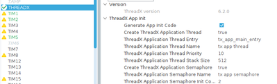

Hi @Christian_Janz  , you have a lot to understand now - using a RTOS , no more "just" a program.
1. no more "main"  = the program ! now many "main" possible, all running (virtual) at same time.
2. read the comment in main.c , and believe it :
now your program is in processing tasks or threads !
so if you dont need this (maybe same me: had to use this Azure just because STM leaves us no choice anymore : want USB , Fat-file system ? then use Azure! )
you can use the first and only thread, that is generated by Cube if you let it do it :
then in core -> app_threadx.c :
i just rename this first thread to  >> tx_app_main_entry << , to see my "main" now by a similar name. :)
so write here, what you in old times wrote in "main" , here my H563 program begins:

That means in main.c  in the while(1) loop is nothing happening anymore?
So If i want to run code, I have to do this in the ux_device_cdc_acm.c?
right.
no more "main" .
your program is in a thread.    maybe...the ux thread.
recommended: first read a "little" about ...
https://learn.microsoft.com/en-us/azure/rtos/
let Cube make a first thread for you , as i wrote . then write there, what you would/want write as your "main".
