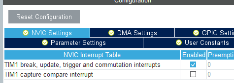

I have enabled the NVIC :

I play around with the breakpoint and can only conclude that, the program went into interrupt immediately after the HAL_TIM_Base_Start_IT(&htim1); and stops the PWM output right away, the interrupt was not triggered by RCR's update event.
My question is how can I solve it? What am I missing?

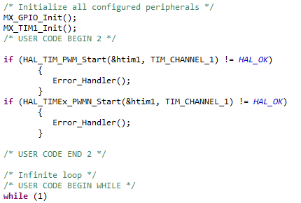

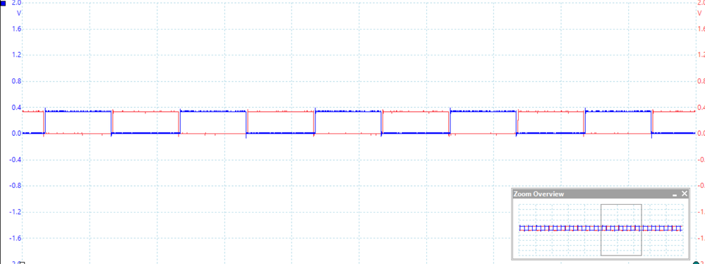

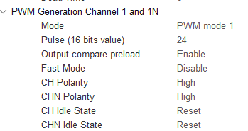

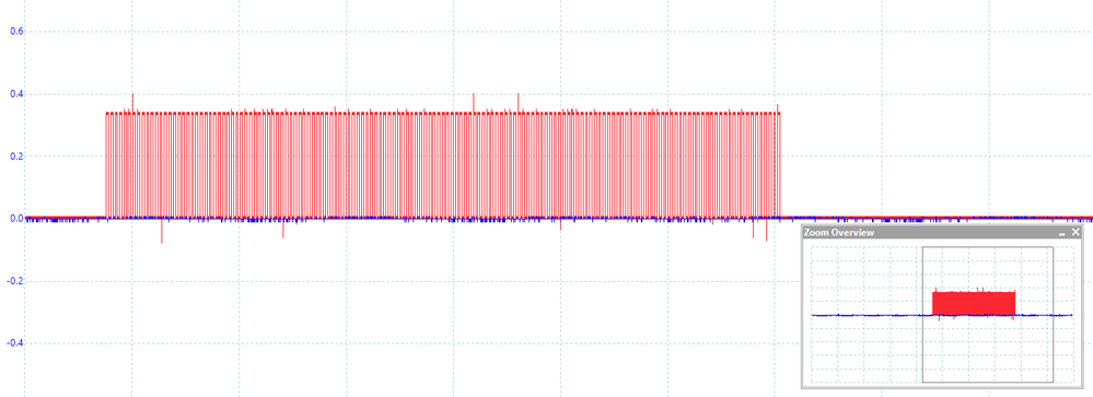

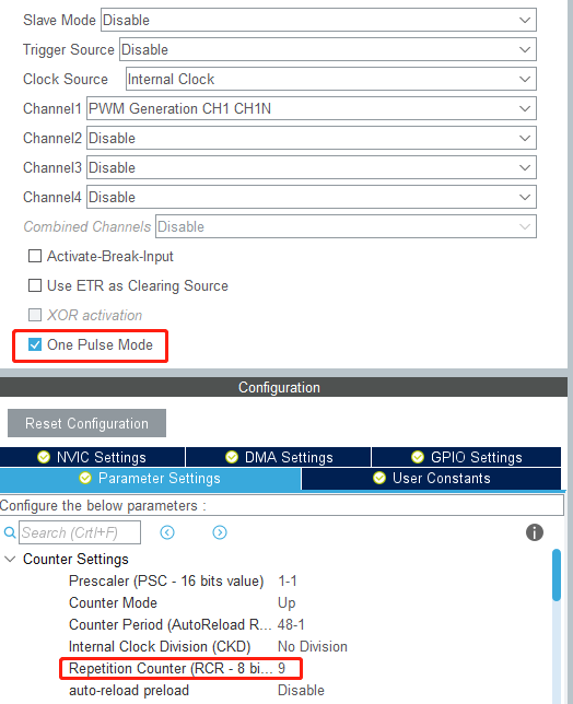

JLuo.1
Hi,Thanks for your reply!
I tried the set up with only Onepulse mode + PWM completmentary output.
Simply as follow:
0693W000005BmnhQAC.png--------------------------------------------------------------------0693W000005BmoBQAS.png--------------------------------------------------------------------
Only outputting PWM:
0693W000005BmoLQAS.png--------------------------------------------------------------------
But there is still no PWM output at all from the start.
It seems that i'm still doing something wrong, can you give me some
suggestion?
Thank you very much in advance!
Kind regards,
JL

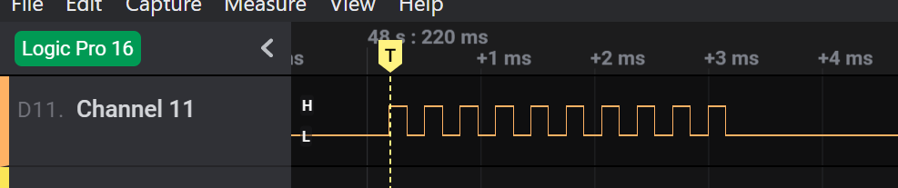

On 2020-11-16 19:11, ST Community wrote:
I'm not sure what the problem is, but I can get this working on the H743 by following the steps you're doing. I don't have an F0 board.
Here's the output showing exactly 10 (RCR + 1) pulses.
Here is the mostly CubeMX generated main.c file. Perhaps you can compare between yours to find the issue. This is the only line I added:

JLuo.1
Hi, thanks again for the reply!
I was setting the PWM output frequency at 1MHz, seeing your project I changed the frequency with your parameters.
And I did see the fixed amount of PWM pulses from my oscilloscope this time!:
which means the method does work! but probably 1Mhz + 10 pulses was too quick for me to observe.
Are you using a logic analyzer to capture the signal? May I know the part number?
Thanks!
Kind regards,
J Luo
