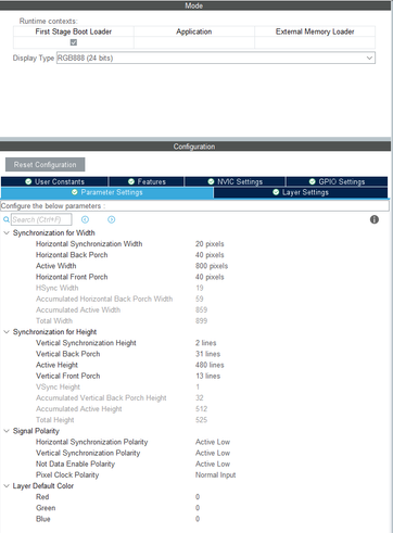

Here are the configuration parameters that I am using based on the data sheet:

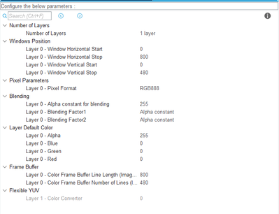

Here are the layer settings that I am using:

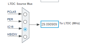

Here is the clock configuration for the LTDC:

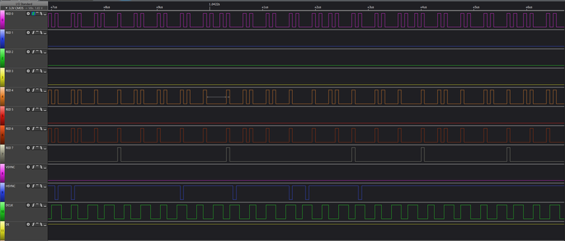

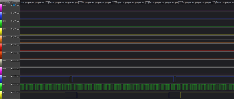

- I’ve hooked up a logic analyzer to the red data pins, HSYNC, VSYNC, DE, and DCLK (below is a snapshot). When the red data pins are not active HSYNC seems to be acting somewhat normally. When the data pins are active, HSYNC does not act normal at all. It pulses almost randomly. Please note that the logic analyzer is a cheap one from Amazon, so it may not even be reading this data correctly.

- I’ve tried slightly adjusting the pulse width settings for both HSYNC and VSYNC. No change.

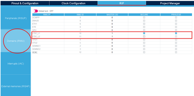

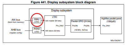

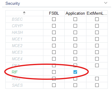

To anyone who stumbles upon this post. I figured out what my issue was. I was using AXISRAM to store my screen's buffer memory, which by itself is fine. What I didn't realize is that the LTDC peripheral does not initially have access to this memory. In order for the display data to get to the LTDC peripheral, you need to use the RIMU.
In order to enable the RIMU you need to enable RIF in the hardware configuration. Make sure to enable it whether you are running your main code in application or in FSBL.
Then go to the RIF tab on the top, go to "Domains (RIMU)" tab on the side, and then give LTDC_L1 (Layer 1, or whichever Layer(s) you are using) privilege and secure status. The way that I understand it, you are telling the microcontroller that the LTDC can have full access to system resources (privilege) and is a trusted peripheral (secure).
Once you do that, you need to add these lines of code.
    RIMC_MasterConfig_t RIMC_master = {0};
    RIMC_master.MasterCID = RIF_CID_1;
    RIMC_master.SecPriv = RIF_ATTRIBUTE_SEC | RIF_ATTRIBUTE_PRIV;
    HAL_RIF_RIMC_ConfigMasterAttributes(RIF_MASTER_INDEX_LTDC1 , &RIMC_master);
    HAL_RIF_RISC_SetSlaveSecureAttributes(RIF_RISC_PERIPH_INDEX_LTDCL1 , RIF_ATTRIBUTE_SEC | RIF_ATTRIBUTE_PRIV);
These lines of code basically do what the hardware configurator is supposed to do. I'm not really sure why the hardware configurator doesn't write these lines of code for you, unless it's not being written in main.c. You will want to write these lines of code before you set the memory address or addresses for any of your LTDC layers.
As soon as I added these lines of code, I immediately saw color on my screen.
