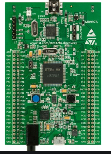

0690X00000AqONDQA3.pngHi,
I am using STM32F4 discovery board. I want to use output compare mode for toggling LED.
So I decided to use Timer4 Channel 1. For discovery board the LED green is connected PD12 pin is connected to LED4: Green .
As per the datasheet, Timer 4 Channel 1 can be used as alternate function for LED green (PD12). So, for the alternate function configuration two registers are there.
AFR[0] (alternate function low register) and AFR[1] (alternate function high register).
How to configure this? What is the exact register value to be placed in this register?

Best answer by waclawek.jan
> //Set the Direction or Mode register i.e. Input or Output , Here PD12 corresponds to 01
> GPIOD->MODER|=0x01000000; //0b 0000 0001 0000 0000 0000 0000 0000 0000
No, you want to set to Alternate Function mode, that's 0b01 for the given field, ie.
GPIOD->MODER|=0x02000000;
For AFR, the field for pin 12 is in AFR[1]. AF for TIM4 is 2:
GPIOD->AFR[1] |= (2 << ( (12 - 8) * 4)); // AFR[1] contains fields for pins 8..15 hence the offset 8; there are 4 bits per field hence the *4

Great. Thanks for the analysis. It's working for me. Understood

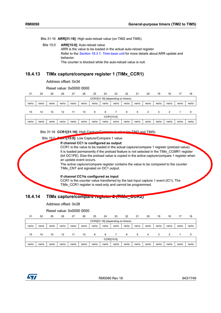

Hi, waclawek,
What is the use of  CCRx Register for the timerx . How to use it and when to use it?
TIM4->CCR1=0; How does this effect?
Can you give an example for this register ?
