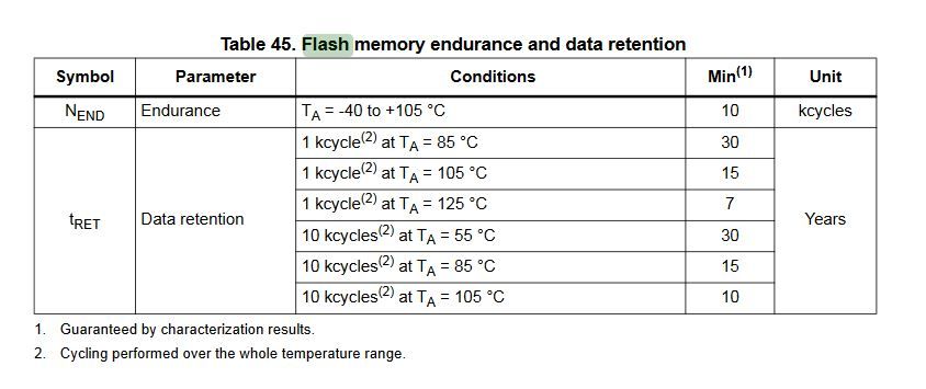

Hello! I'm using the STM32G071CBT6 controller for my project. I need to store certain values in EEPROM for my project, but unfortunately, this controller doesn't have built-in EEPROM functionality. Despite this limitation, I'm determined to find a solution to store data effectively. I've searched extensively, but I haven't been able to find any example code specifically for the STM32G0 series. If anyone has example code that demonstrates how to use the flash memory as EEPROM, I would greatly appreciate your suggestions and guidance.

We use this type of storage for both the F series and the G series. Couple questions before you dig yourself in deep.
- How frequently do you need to write the data? ST micro flash can only be erased approximately 1000 times(this number is hard to find) as flash on these devices is really designed for holding code(older flash could be erased in the 100K range.) If the data is only configuration stuff that is updated infrequently you'll be fine. If your writing out error logs the code will have to be much more complex as you will need to track the number of sector erases(the G series refers to these as Pages.)
- If you decide that you will not burn the flash out by writing to many times, then find how big the Page(or Sector) sizes are and how large do the flash writes need to be. F series allowed you to write 4 bytes at a time where the G series that we use need to be 8 bytes at a time. Size your data structures accordingly so you keep everything aligned.
Some code below will give you an idea of storing configuration data that is NOT written to frequently.It's just basic stuff but should give you some idea of storing configuration information.

		while (tempAddr_p < end_p)
			// We are writing 8 bytes at a time to flash because the STM32G0B0RE can
			// only write 8 bytes at a time.
			HAL_FLASH_Program(FLASH_TYPEPROGRAM_DOUBLEWORD, (uint32_t)tempAddr_p, *tempData_p);
			tempAddr_p += 2;
			tempData_p ++;
		// Both the image header and configuration have been written out, lock the flash.
		HAL_FLASH_Lock();
	else
		rc = 1;
	return(rc);
