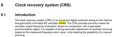

I am using STM32L072CBT6 for my project and I need USB interface.
Is there any option to drive USB using HSI_RC ?
Also we are using STANDBY_WITH_RTC for low power mode.
Is there any way to wake up the system from low power mode using USB ?
As stated in the reference manual, crystal-less USB requires you to use the HSI48 clock. On the CubeMX clock select screen, this is the "RC 48 MHz" clock.
Yes, the STM32L0x2 series supports crystal-less USB. Look at the Clock Recovery System in the reference manual.

My issue is not solved. Please check the attached images of CUBEMX CLOCK Configuration.
Attach your IOC.
Thanks for the quick response.
Here I am attaching the IOC file. We can not use External clock source for USB application. Please provide us with a solution of internal/crystal less design for USB.
