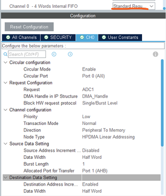

I searched a bit and find something strange, the HAL_ADC_MspInit() function seems to initialize the DMA with some lines for a linked list:

    if (HAL_DMAEx_List_BuildNode(&NodeConfig, &Node_HPDMA1_Channel0) != HAL_OK)
      Error_Handler();
    if (HAL_DMAEx_List_InsertNode(&List_HPDMA1_Channel0, NULL, &Node_HPDMA1_Channel0) != HAL_OK)
      Error_Handler();
    if (HAL_DMAEx_List_SetCircularMode(&List_HPDMA1_Channel0) != HAL_OK)
      Error_Handler();
    handle_HPDMA1_Channel0.Instance = HPDMA1_Channel0;
    handle_HPDMA1_Channel0.InitLinkedList.Priority = DMA_LOW_PRIORITY_LOW_WEIGHT;
    handle_HPDMA1_Channel0.InitLinkedList.LinkStepMode = DMA_LSM_FULL_EXECUTION;
    handle_HPDMA1_Channel0.InitLinkedList.LinkAllocatedPort = DMA_LINK_ALLOCATED_PORT0;
    handle_HPDMA1_Channel0.InitLinkedList.TransferEventMode = DMA_TCEM_BLOCK_TRANSFER;
    handle_HPDMA1_Channel0.InitLinkedList.LinkedListMode = DMA_LINKEDLIST_CIRCULAR;
    if (HAL_DMAEx_List_Init(&handle_HPDMA1_Channel0) != HAL_OK)
      Error_Handler();
    if (HAL_DMAEx_List_LinkQ(&handle_HPDMA1_Channel0, &List_HPDMA1_Channel0) != HAL_OK)
      Error_Handler();
    __HAL_LINKDMA(hadc, DMA_Handle, handle_HPDMA1_Channel0);
    if (HAL_DMA_ConfigChannelAttributes(&handle_HPDMA1_Channel0, DMA_CHANNEL_NPRIV) != HAL_OK)
      Error_Handler();
    /* USER CODE BEGIN ADC1_MspInit 1 */
    /* USER CODE END ADC1_MspInit 1 */
 But I did not configure a linked list in CubeMX:
Is my HAL_ADC_MspInit() function incorrect?
