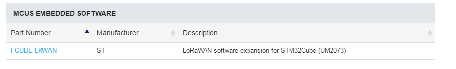

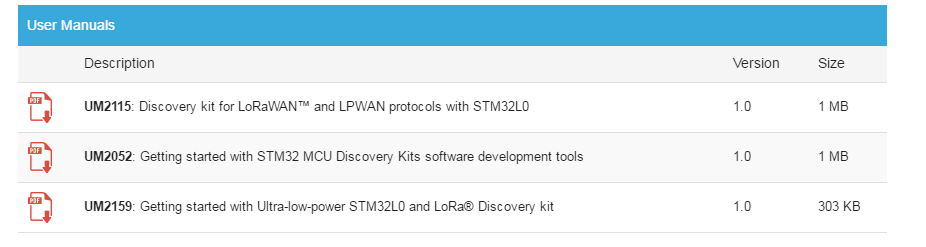

You have in the
/external-link.jspa?url=http%3A%2F%2Fwww.st.com%2Fcontent%2Fst_com%2Fen%2Fproducts%2Fevaluation-tools%2Fproduct-evaluation-tools%2Fmcu-eval-tools%2Fstm32-mcu-eval-tools%2Fstm32-mcu-discovery-kits%2Fb-l072z-lrwan1.html
page User manuals and a link to the
http://www.st.com/content/st_com/en/products/embedded-software/mcus-embedded-software/stm32-embedded-software/stm32cube-expansion-software/i-cube-lrwan.html
software expansion for STM32Cube with UM2073 user manual.
Hope this helps you.
Regards
Imen
