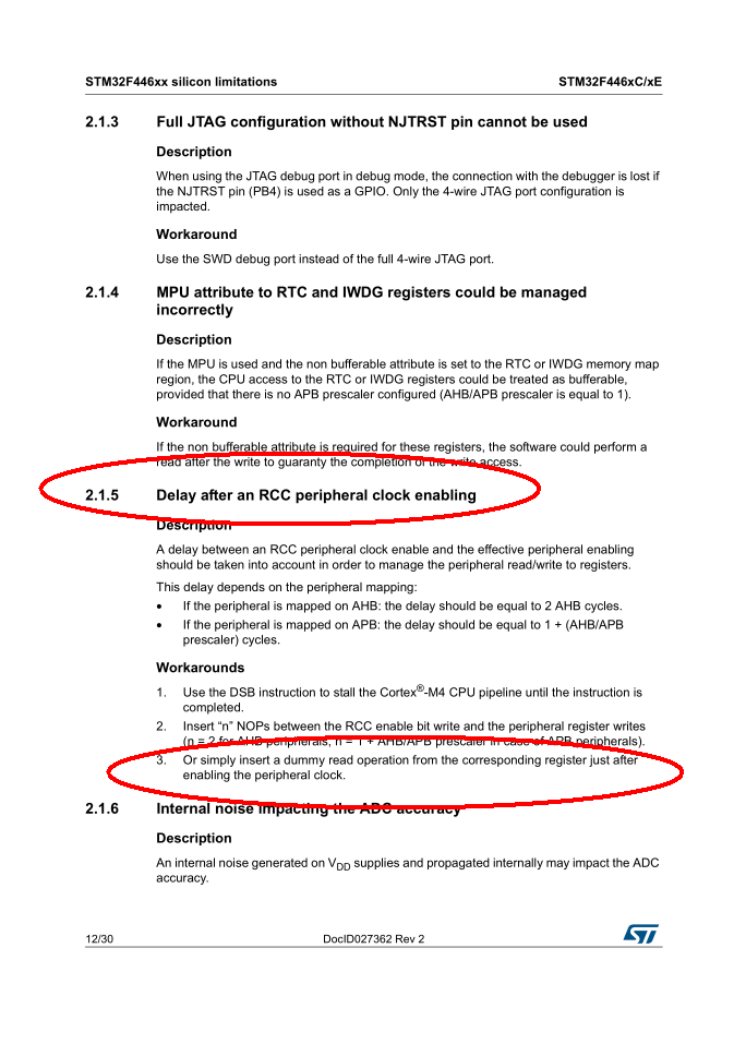

> Didn't find a hint in the ref man that this is needed.
Because it's an erratum workaround.
IMO the Cube writers don't quite understand the rationale of that workaround: you are supposed to read register from the just-enabled peripheral, not from RCC; but as GPIOs are on the same AHB bus as RCC, in this particular case, this works.
I see, thanks. Would be nice having cross references in the source code.
