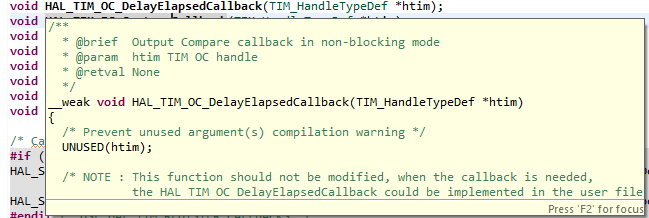

Thanks for the answer, I know that cube is open source, of course I already went to see the HAL_TIM_IRQHandler function but I didn't find/understand what I was looking for.
Here is a piece of code where I tried to implement the HAL_TIM_OC_DelayElapsedCallback() function which I think is the function I'm looking for.
I have a breakpoint in this function, but my program never returns in this function and I don't understand why.
"Output Compare callback" but i dont' understand why she's not working in my program ...
Place a breakpoint into the ISR itself (i.e. that function I copied out above). Does the program reach that point? If yes, find out where does it go instead of your HAL_TIM_OC_DelayElapsedCallback. If not, debug as usually for interrupts.
PS. Where do you enable the given interrupts in TIMx_DIER?
‎2021-01-25 6:01 AM
By placing a breakpoint in the ISR, the program does not reach the breakpoint but goes directly to this line:
/* Process Locked */
__HAL_LOCK(htim);
‎2021-01-25 6:13 AM

‎2021-01-25 6:50 AM
Line 3418 in the above file is in HAL_TIM_OC_ConfigChannel() - that's not in ISR.
I don't know what is authorization. I don't use Cube/CubeMX.
‎2021-01-26 12:04 AM
Oh yes, you're right!
I looked and my breakpoint is well in ISR.
But then when I debug, my program is redirected to this line __HAL_LOCK ...
Edit : I tried to recreate the same project but on a STMF429, same problem, my program blocks at __HAL_LOCK ...
