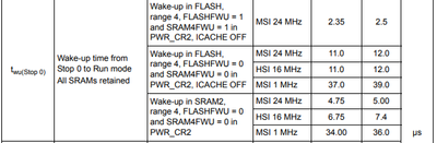

Is there any specific guidance regarding how to improve wakeup time from the various STOP modes? The U5 Reference Manual mentions that configuring STOPWUCK = 0 will use the MSIS up to 24 MHz, which would be faster than HSI16. I've used that already but am wondering if there is anything else.
I notice that when running inside the debugger STOP0 wakeup times improve by roughly 100-150us. I'm targeting 100us. Presumably that has something to do with how the DBGMCU is configured. So the MCU seems capable of waking up faster in this modified STOP0, although with lesser power savings. Still, power savings using STOP0 from within the debugger is substantially better than SLEEP outside of the debugger (meaning normal device operation). Are there other options to shorten the time, outside of DBGMCU configuration?

I recommend you to look at the datasheet of your device here you can find the u585 data information. If you go to chapter 5.3.7 Wake-up time from low-power modes and voltage scaling transition times
you will find the data corresponding to twu wake up time :
So 100µs can be reach in stop 0.
note: consumption in stop0 with "debugger" is not the consumption of U5, please report as well to datasheet to know the target you can achieve according to IPs enabled.
Best regards,
Mikael
here the web site of all U5 documentation : https://www.st.com/en/microcontrollers-microprocessors/stm32u5-series/documentation.html
‎2023-09-11 2:42 PM
Thanks for the reference to that table, @MikaelM . After looking at the listed conditions, I tried adding these lines of code:
LL_PWR_EnableFastSoftStart();
LL_PWR_EnableFlashFastWakeUp();
LL_PWR_EnableSRAM4FastWakeUp();
I used these lines 2 different ways: 1. before calling HAL_PWR_EnterSTOPMode() or 2. after it returns. Either which way, the wakeup time actually increased by about 50us. I also tried combining this with HAL_ICACHE_Disable() with similar results.
Is there a working example somewhere? If I hack it using LL_DBGMCU_EnableDBGStopMode() the time decreases by roughly 100us, which at least is going in the right direction although it's still not close to the times listed in the table.

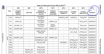

And if you just have an oscilloscope I recommend to do the following :
1/one probe on your wake up signal (gpio preferred)
2/program one gpio as ALTERNATE 15 to have access EVENTOUT signal (second probe here)
3/if you use WFE => then the first instruction executed after is SEV ==> you will have the time twu between your 2 oscilloscope probes.
4/If you use WFI => you can toggle a gpio in your ISR (but some delays added)

So I have the PWR_EnterStopMode example using a user button for wakeup, along with __WFE(). I'm using a logic analyzer @ 100MS/s to observe the "LED" toggle output (not an actual LED on my board, just an output), the button used for wakeup, and PA5 which I'm trying to use as EVENTOUT. I can see the button press edge followed by the LED, but no activity on PA5. Seems like there something I need to do in addition to the code below to hook PA5 to the SEV event, but I don't know what that is:
GPIO_InitStruct.Pin = LL_GPIO_PIN_5;
GPIO_InitStruct.Mode = LL_GPIO_MODE_ALTERNATE;
GPIO_InitStruct.Speed = LL_GPIO_SPEED_FREQ_LOW;
GPIO_InitStruct.Pull = LL_GPIO_PULL_NO;
GPIO_InitStruct.Alternate = LL_GPIO_AF_15;
LL_GPIO_Init(GPIOA, &GPIO_InitStruct);
I also tried explicitly adding __SEV() after __WFI(), but still no output was observed.

Please try this :
in main() between /* USER CODE BEGIN 1 */ and /* USER CODE END 1 */
LL_GPIO_InitTypeDef GPIO_InitStruct= {0};
__HAL_RCC_GPIOA_CLK_ENABLE();
LL_GPIO_ResetOutputPin(GPIOA, LL_GPIO_PIN_5);
GPIO_InitStruct.Mode = LL_GPIO_MODE_OUTPUT;
GPIO_InitStruct.OutputType= LL_GPIO_OUTPUT_PUSHPULL;
GPIO_InitStruct.Speed = LL_GPIO_SPEED_FREQ_HIGH;
then at the position where you call stop mode :
HAL_PWR_EnterSTOPMode(PWR_LOWPOWERREGULATOR_ON, PWR_SLEEPENTRY_WFE);
LL_GPIO_SetOutputPin(GPIOA, LL_GPIO_PIN_5);
So in that case, PA5 will be set high just after wakeup (some clock delays but it's acceptable). And then you will be able to see on an oscilloscope the delay between you push button and the PA5 signal.
