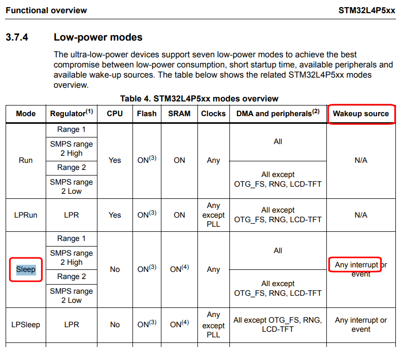

@FLuba.1 wrote:
LTDC prevents CPU (of my MCU) from going into sleep mode.
How do you know that it actually prevents entering sleep?
@FLuba.1 wrote:
When i deactivate the LTDC clock, the CPU goes to sleep mode. LTDC interrupt is enabled trough IOC
Maybe it does enter sleep, but then there's an LTDC interrupt which immediately wakes it?

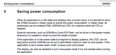

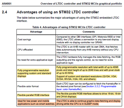

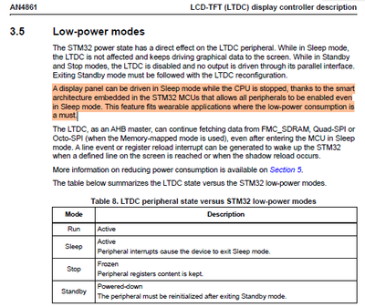

According to the following AN, it should be possible to enter sleep mode(and remain in sleep mode) while using LTDC.
Yes, but you need to ensure that it's not generating interrupts - because interrupts will wake the CPU...
Yes, i understand. I have tried in the past, to let the screen work without interrupt, it didn't work. Can LTDC let a screen work without  interrupt?
I will try it again. I hope i won't take me a lot of time.
