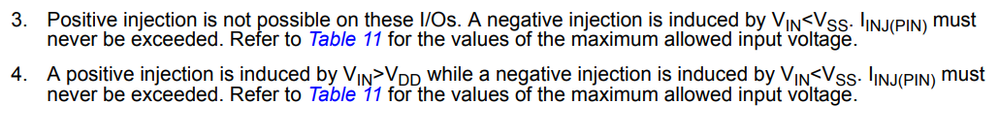

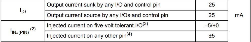

2. VIN maximum value must always be respected. Refer to Table 12 for the values of the maximum allowed
injected current.

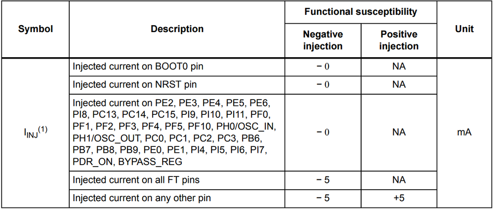

And also the section "5.3.15 I/O current injection characteristics" and "Table 47. I/O current injection susceptibility".
My conclusion is that +3,3 mA seems to be OK for edge cases, but not for normal prolonged operation.
MSauv
@Ozone​ , @Piranha​ , Thank you for your help. Below the important bits of some charts @Piranha​ referenced. Based on these I have also come to the conclusion that adding 1k resistors in series with the UART rx/tx lines will protect the STM32 since the 3.3mA current injected will be withing the limits.
