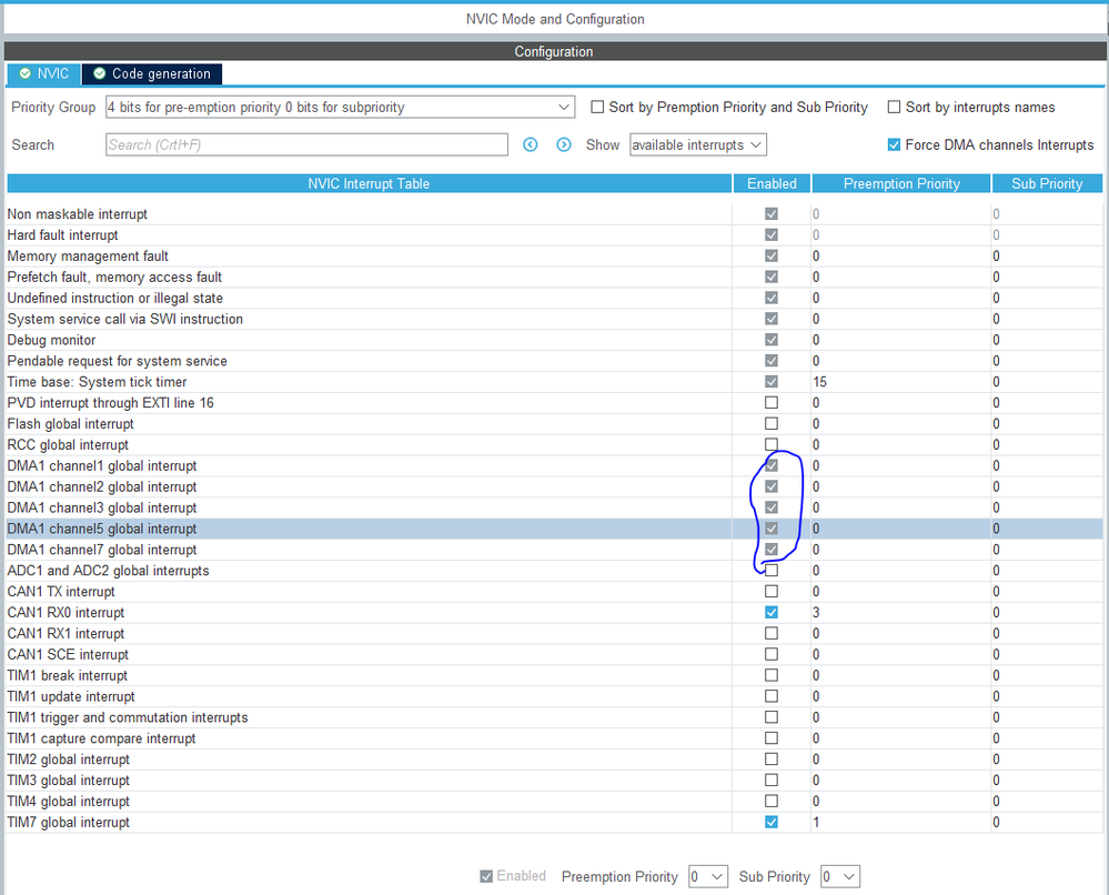

@Piranha​ CubeMX for some reason autogenerates ISR functions when DMA is activated
They prevent you from "unticking" the NVIC enable option.
I dont need them and i dont want them..

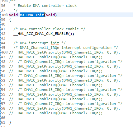

0693W00000NpD58QAF.png@Community member​ I placed some breakpoints in the ISR callbacks and they are never reached.... (probably because im using HAL_DMA_Start() instead of HAL_DMA_Start_IT() )
I just removed all ISR init code and callbacks ,the DMA still works as intended,The interruptions were not being triggered nor used.0693W00000NpD5rQAF.pngThe original problem is still there but now i know , the issue is not in the ISR functions.
This is why Placing the Vector table in RAM was not improving performance.
