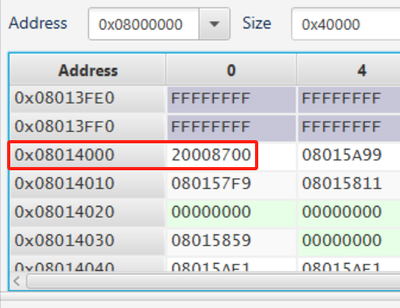

A few minutes ago, after I modified the bootloader to use the same highest address of the user stack,  I printed out the values of the first address of my App (which is 0x08014000), it's 0x20008700, this is the highest address of the user stack being used in the Bootloader and App, 0x20008700 = _estack = ORIGIN(RAM) + LENGTH(RAM) - 14592. Then I did following test:
1. change the _estack in Bootloader back to _estack = ORIGIN(RAM) + LENGTH(RAM) - 256
2. in main() of App,add the following code to modify the value of the first address of the App:
int main(void)
  /* USER CODE BEGIN 1 */
#ifdef	BOOTLOADER_PRESENT
	uint32_t* sp = (uint32_t*)(APP_ADDR);
#else
	uint32_t* sp = (uint32_t*)0;
#endif
  sp[0] = MAX_STACK_POINTER;
  /* USER CODE END 1 */
APP_ADDR = 0x08014000 (the first address of the App)
MAX_STACK_POINTER = 0x20008700, this is the value read out when the App was running correctly.
Unfortunately, it didn't work!

My previous test was invalid.
I checked the device memory in CubeProgrammer, the value of the first address of App was already set by the linker to 0x08008700 in the bin file according to the settings in .LD file.
